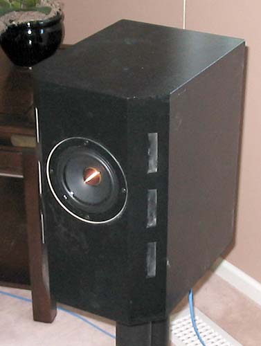

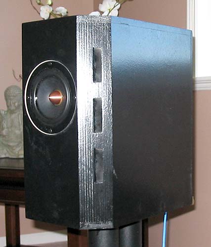

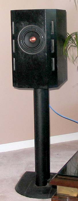

miniOnkens ... these have some real interesting cosmetic potential (can't wait to see what Scott comes up with in solid wood)
The construction of these makes them inherently solid....

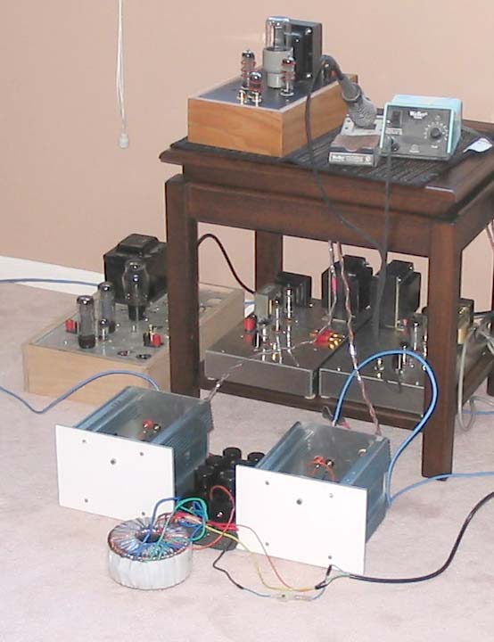

Jason's miniAs (in full UL approved format 😀) and the 3 SE amps that the FRs drove into conniputions (RH34, stock Decware ZEN, and the parafeed monoblok EF86/EL84 RH inspired SEs -- that all 3 amps exhibited the same problems made the problems we initially had hard to diagnose)

Except for the Mini a's. The speakers didn't no porblems with them.

morbo said:
Wow that Mini-O looks cool, kind of like those D-Box 'mammoth' subs that AudioIdeasGuide used to rave about. Any details about that enclosure? Is it just a slot-ported box with multiple ports?
No idea about the D-Box (except that is is pricey). Once we nail these i'll publish the plans on my web-site. So far things are looking good. Just ran impedance... based on that they should have F3 in the 55 Hz neighborhood, and hopefully the resistive nature of the ports will give a less drastic roll-off than a typical BR.

For the benefit of readers, the short story is that in both enclosures, (the Onken inspired and Tim's bipole MLTL) 3 different SET tubed amps ( Decware Zen Select, and 2 experimental homebuilts) sounded absolutely broken with the WR & FR drivers. The absolutely worst case of amplifier imcompatibility I've heard in over 35yrs, and quite disheartening with Bob sitting in the room. :dead:
Fortunately, someone finally suggested we switch to a differnent amp topology.
With the Pass Mini-A (ask Jason for model details) or relatively stock Jolida 302 (EL34 PP triode strapped) no problems at all. Excellent bass extension and articulation on the SS, but rather dry/thin midrange and collapsed soundstage compared to the tubed amp.
