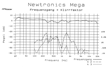

Newtronics Manger distortion
I have been wondering about disto measurements for the Manger. The link Charles provided had a very interesting plot taken from the magazine HifiVision.
Unfortunately, there is no information at what absolute sound pressure level this was measured. If it was 100 dB, it is not scary. If it was 85 or 90 dB, it might well be, with 3rd harmonic at 3.2% between 400 and 800 Hz and 2nd at >5% at 1.5 kHz (conventional wisdom has it that midrange disto should be below 1% for a good speaker).
I am also not sure how much of this disto is caused by the additional tweeter. The peak at 1.5 kHz coincides pretty well with the dip in the frequency response around 1.6-1.7 kHz that can be seen in the frequency response plot of the bare Manger driver as well as plots of all finished speakers that I have seen (Zerobox 109, Medea II, Swing).
So the response dip seems to be something fundamental to the driver, and whatever the mechanism responsible for the dip, it may also be responsible for harmonics generation.
I wonder why nobody (to my knowlegde) has tried to compensate that dip electronically. The reason might be that distortion would increase to even higher values.
Eric
This is the plot. Note that for the other dips at 300 and 700 Hz, there is also a disto peak at or slightly below this frequency.
The 700 Hz dip can also be found in the bare (open infinite baffle?) Manger data sheet plot, but is less pronounced. The 300 Hz dip does not appear in the data sheet.
Eric
Eric: The graph for the distortion You´ve posted is very interesting and me too wonder about the high values:bigeyes:
I have the particular Hifi-Vision edition from April 1992 and the test report of the "Mega": I took a look about the distortion measurement conditions. They specified: 90dB@1m🙁 , test signal: sine wave
The frequency response graph of the "Mega" cannot directly compared with common measurements as Hifi-Vision used a somewhat unusual setup. They used to have a rotating mic. and a computer software to integrate and weight on-axis and off-axis data into a single graph.
Also the Manger drivers of the "Mega" from 1992 are not completly identical to the latest version drivers today.
I do not care much about the dip at about 1,6kHz as this is too small and of too narrow bandwith to play a significant (negative) role and equalizing is not really neccessary IMHO but I agree that this might have something to do with the distortion behavior.
The acoustical phase response graph at the Manger site also indicates that there must be some kind of (serious?) resonance.
The dips at 300Hz and 700Hz ("Mega" graph) cannot be judged correctly without knowing how exactly the datas were derived. Also for the lower frequency one would have to know the low-pass xover point and sloop from the woofers. And last but not least the "Mega" has 3 Mangers per box and taken into account the rotating mic. thing, I think these datas from the "Mega" do not tell us much about the Manger itself.
I can`t see a 300Hz dip at the original Manger graph. Also Manger has not specified the baffle and enclosure size for the measurements and the corresponding graphs (I`ll never understand what a graph should be of worth without specifying the measurement setup and test conditions - it`s like to say a thing has a length of 20 .... what?: meters, inches, mm, km...)
Anyway I believe all that (minor IMHO) frequency deviations can be ignored respectively controlled with the crossover but what concerns me much more is the distortion (maybe I`ll email Mr. Manger and ask about if he ever measured distortion versus frequency for his drivers).

Somehow, the plot I posted has disappeared over the weekend, hence a repost:
