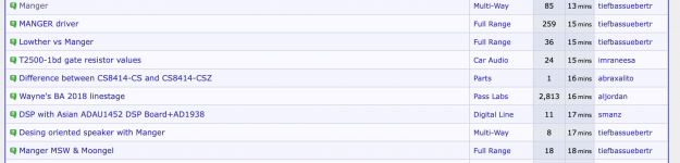

Yes. For this reason, I got the review I wanted quickly - go to the URL (post #31) of my previous post.Haha - you "managed" to update 4 threads of Manger oriented posts at the same time!!
No, 5 ACTUALLY ;-D
