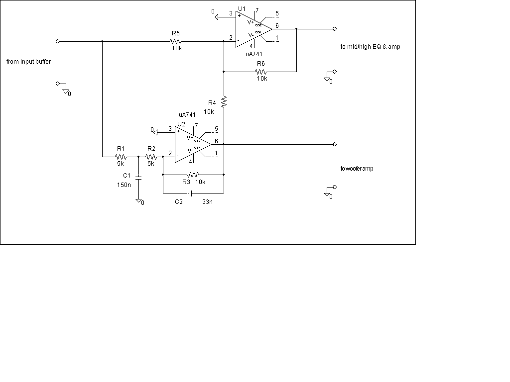

Hi all
For the impatient ones I post the schematic of the bare crossover network below.
Before someone starts throwing flames at me for using the 741 OPs:
I did of course not use these in the circuit but they were just handy to draw this diagram (i.e. I was too lazy to import another model into P-Spice).
The values are the current ones and are still experimental.
If you regard the frequency, where both outputs are equal in amplitude, as the crossover frequency, then it is 220 Hz approx with the values shown.
Because the MSW's lower cutoff frequency is only about an octave below the crossover frequency, it's inherent phase-shift disturbs the whole arrangement a bit.
Therefore a "gentle" notch filter is used around 100 Hz after the highpass output. I will publish values and circuit later on, as soon as I have been able to perform measurements.
This crossover topology might also be useful for users of other FR & woofer combinations if the crossover frequency is altered accordingly.
Depending on what power amplifiers are used, the summing OP-AMP and R6 may be omitted and the higpass output taken from the node between R4 and R5. For this purpose the amp should have high input impedance and 6dB more gain than with summing opamp. Additionally the high output would be in-phase and the low output inverted, whereas both outputs are inverted when the summing OP-AMP is used.
For those who would never dare to use any OP-AMP (though an OP-AMP in this configuration will have good THD and IMD performance): The circuit can as well be built with transistors or tubes but there would be some additional coupling caps needed.

Hi Eric
So you got yourself a pair of MSWs as well ? What type are they - the rare-earth ones ?
BTW: The (almost frightening) clarity of female voices was an experience I also had when testing the drivers for the first time. Needless to say that I ran them fullrange as well.
I have also read the article in Klang & Ton and I was a little disappointed to see that the LF part uses "a box with holes" !!!!
The main culprits for the bad step-response for this project are the use of a vented box and the crossover type used IMHO.

In the K&T article, they use a second order subtractive filter with delay à la Lipshitz and Vanderkooy (actually, they referred to the Duetta aktiv article where they more or less claimed the filter was transient perfect. This means the woofer has a second and the Manger a forth order slope => really strange! Actually, the Manger might benefit from a steeper XO, but at least you'd want to see matched slopes.
The whole construction description was poor. I wonder whether they want to use stuffing material right behind the Manger. Maybe that causes the bad disto behavior.
How's your filter coming along?

New guy here. Interesting thread. I believe the higher order subtractive filters can be made transient perfect. To generate the highpass, you delay the full-range signal by a time equal to the group delay of the lowpass, before you subtract the lowpass from it. The catch is the delays are so large that it almost requires a digital circuit.
A Bessel lowpass, even a very steep one (4th - 10th order), with a flat group delay, gives a second order highpass and perfect summed response. An LR lowpass, with a small hump in the group delay, gives a 3rd order highpass and the signals sum "pretty well." Adding just a little extra delay, using the LR lowpass, you can get a 4th order initial rollof on the highpass and the summing isn't "too bad."
John Kreskovsky, of the FRD group, has a spreadsheet that lets you play with this stuff. It's based on the work of Lipshitz and Vanderkooy (spelling?).
http://www.geocities.com/kreskovs/new-xooz1.html
Read the notes in the spreadsheet. The example on the web page is the "not too bad" 4th order lowpass and 4th order highpass. The step response still looks pretty decent considering you will be applying it to real-world drivers.
All that said, it looks interesting but I haven't tried it. My plan is to get one of the DSP boxes (QSC, Rane, etc.) with a CAD-style interface that lets you draw your signal routing and give it a try.

I downloaded the QSC software and sketched out a possible digital implementation of JohnK's delayed, subtractive XO. Outside the XO, you need to EQ each driver as flat as possible, especially around the XO freq. As well, you need to time-align the acoustic centers outside the XO. The idea is you want to be sending a perfect waveform to "perfect" drivers. Baffle step, etc. would be handled by the "Room EQ" block on the input.
This principle would indeed work and I was thinking of it years ago although for a mini P.A.
Personally I'd prefer an analog circuit simply because of issues like dynamics and frequency response.
If you want the full bandwidth of the newer media (SACD & DVD-A) then you have to go for 196 ksamples/second. Combined with the long filter length due to the low crossover frequency this would ask for a DSP with some hundred MIPS !
