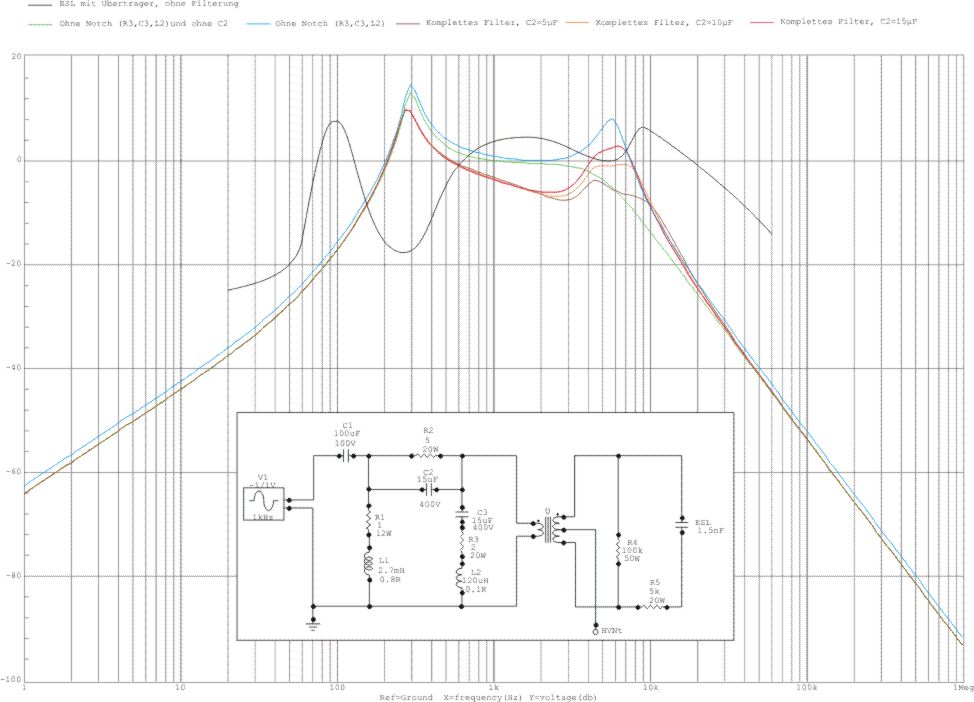

I have read some different opinions regarding the way the curved ESLs of Martin Logan work.
Some claim that the crossover of for example the Sequel2, has frequency corrective elements. Others claim that this is not the case and it is all about impedance correction.
Because beaming of high frequences is largly reduced by the curved design, one should expect that there is only little correction needed in the frequency response.
Who knows about this???

If you post the schematics it would be easier to see what is what.
The curve reduces slightly the HF beaming, but not entirely.
In general the ML's interface - at least the ones I've seen - are somewhat inferior to some of the patented schemes that have been used for matching the xfmr(s) to the cells... for this reason they ended up with a hyper low imput Z with their original CLS design...
Generally speaking, you can't "match" a step up device to a given "full range" cell and still have good sensitivity - the tradeoff is sensitivity vs. bandwidth. This was shown nicely by Peter Walker in his 1950s articles on ESLs in Wireless World. Similarly, if you match for good HF extension, you'll probably have weaker bass... which will "work" if you knock the HF down so that you end up with a nominally "flat" response... this may be what ML was doing with the CLS. Not sure.

Martin You guess right. The Sequel 2 needed quite heavy equalizing. First of all the frequency response of the panel itself wasn´t that linear. Second the quality of the audio trannies was quite cheap, with a too great leakage inductance, that lead to a resonance peak around 7kHz with a -12dB slope above that resonance frequency. See the attached pic.
C1 in togetherness with L1, R1 and the ESL gives a very steep highpass response with a lot of overshoot (R1 is used to damp the overshoot) to correct the phase cancellation of the panel itself. R5 is used to get the efficiency down to woofer level and C2 corrects the falling response above 7Khz. The notch (C3, R3, L2) corrects the midrange around 3kHz.
PDF:
black: principle frequency response of panel and trannies
green: electrical frequency response of ESL with crossover but without C2 and notch
blue: electrical frequency response of ESL with crossover but without notch
brown: electrical frequency response of ESL with crossover but C2=5µF
orange: electrical frequency response of ESL with crossover but C2=10µF
red: electrical frequency response of ESL with crossover (original, C2=15µF)

The measurements are very interesting. But I always thought that elektrostatic panels itself have a linear frequency response automatically (at least to a very large extent). Only limited by the mass and tension of the film. How is such a non flat response possible (like the Sequel). Where is the difference between the Sequel and the Prodigy? Mechanical difference?
Thanks for each explanation.
Thomas
Flat response
ESL´s show good linearity measured under nearfield conditions, but not necessarily under farfield conditions. Apart from room interactions there´s phase cancellation that spoils linearity below a certain frequency thats determined by the physical properties of the ESL. Furthermore standing waves occur on the membrane depending on the size, diaphragm tension, diaphragm properties and the surrounding of the membrane (e.g. a 17cm wide diaphragm will nearly always show unlinearities around 1kHz and 2kHz).
