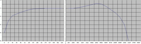

Slightly offtopic, but I assume the ML use a transformer? I saw some small ones for only $2200 and I might pick up a pair in a few months, assuming there's a way to remove the transformer so I can hook up a direct drive high voltage amp. What's the step up ratio of the transformer?
Yes they use a tranny and it will probabely be around 1:75.
But that doesn´t help You much, because You still don´t know how much voltage the panel demands. If You want to use a DD-amp, simply measure the d/s towards the back stator. The distance in mm times 2 is roughly the peak voltage the amp should deliver, which is nearly the same as the power supply voltage of the amp. As far as I know You can drive ML panels with amplifier supply voltages of 2-2.5kV. If You accept some penalty with regard to dynamic headroom, You might fudge a bit and choose values down to 1.5kV, but that still rules out simple DD-amps built with transistors (those are limited to ~1kV).

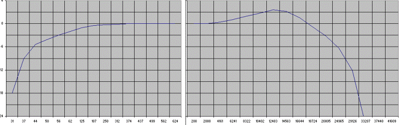

Martin Logan CLS II Crossover / Step-up Transformers
My appologies for tagging onto this thread, but its the most related one I could find and I was unable to start a new thread.
I have the opportunity to purchase some Martin Logan CLS II ESL speakers which will include the power supplies but are missing the crossovers.
I have a Schematic for the crossovers which call for a 1:75 and 1:100 step up transformer.
I hear many people talk about how these transformers can be had for less then $50 ea. However going to the Manufacturer they are asking around $250 ea.
I really don't want to spend $1000 on 4 transformers.
As for the transformer values, (1:75 / 1:100) Much of the information I find online for do it yourself step up calls for 1:50 and 1:200, quite a bit off the reference provided by Martin-Logan.
Any recommendations?

without going to far into detail, the earlier MLs of the 1990s used some pretty cheap and even really bad trannies. But since they fitted into the concept well, the end result was ok too. If You choose now a different transformer -even if it is clearly a superior one- You may end up with a worse result. While this isn´t so much an issue with the ´bass´-transformers, it will most probabaley be an issue with the ´mid-high´-transformers.
