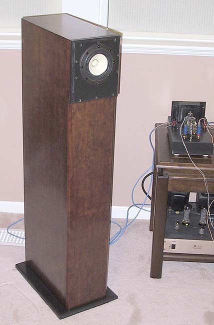

I thought it might be a good idea to try to clarify my idea of stuffing the CC; I hope Ropie won't mind me spoiling his diagram.
1) is a little strip of sheep wool, filtering out some frequencies and damping some unwanted interactions between the horn and the CC; it is the only thing that blocks the air stream directly.
2) is the felt belt, consisting of 1mm thick material which is glued to the walls in order to dampen reflections. Depending on the material you choose to seal the CC, it might also make sense to use it at the back of the CC, too. I use a layer of cork here, but cannot say whether this is the best solution (for me).
I can only say that I have no "honking sounds" und due to the moderate damping the driver can "breathe" with excellent HF extension.
In my B-horn FE108ES setup, I only use sheepwool (about 10" by 15" rolled loosely) in the CC and nothing in compartment 2, throat or mouth. The dynamics are scaring me and (to me that is) the frequency response is pretty even. Didn't measure it though. Placement in your room and distance from the wall seems the most important and by far easiest way to experiment and get good results.
Oliver - thanks
I don't thing we have a misunderstanding on dynamics, but from your clarification and sketch in the last 2 posts, it's clear that I overdamped the reduced compression chamber.
As it turns out, the speakers have found a happy new home, back in the original configuration. Had I enough time, I might have resolved my error.
But there's always next time, which I'm currently thinking FE168E Sigma - just looking for a design that works as well as the BHorn did with the 108.
