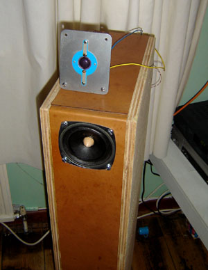

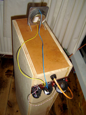

A quick upgrade to my Buschhorns - the addition of an old metal framed tweeter with it's original passive crossover left in place. The difference is quite noticeable; on good recordings they give extra depth to vocals and cymbals. Don't ask me about their values as I haven't got a clue..
Ropie said:the addition of an old metal framed tweeter with it's original passive crossover
what kind of tweeter/ XO?
I found that the 1197 needed help above 10-12k. Typical 8 ohm nominal tweeters with 2 uF cap.
dave
Hi Dave, I don't know anything about the tweeter or crossover other than they came from my old Wharefdale Lintons (6 ohm '70s bookshelfs that were always fluffy in the bass but good in the mids and highs).
The crossover is probably overkill so this w/e I might take it out and install just some 3.3 caps that I have laying about. As you say, the 1197s have benefitted from some help in the high frequencies, plus the build quality of these tweeters is sturdy to say the least.
Ropie said:6 ohm... install just some 3.3 caps that I have laying about
That should be just about right.

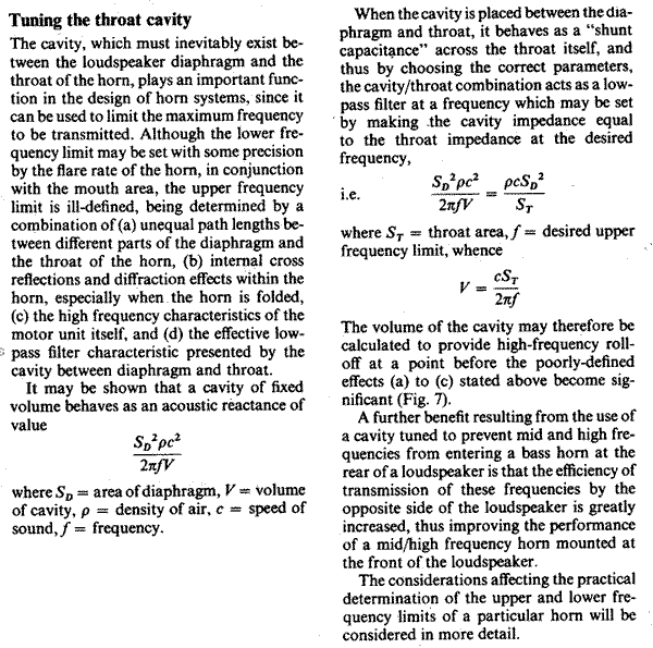

Compression Chamber
A quick question about Compression Chamber.
I too build the Buschhorn using 108ESigma and have left the compression chamber as it is. Read from earlier messge that 108ESigma should have a smaller compression chamber and some have mentioned about adding cork sheet or wood to cover it up so as to make the CC smaller.
My question is, what is the effect of a smaller compression chamber?
Thanks.
Thanks.
Re: Compression Chamber
the size of the compression chamber determines the frequency of the low pass on the sound getting into the horn.
Leach defines it as Vb = Vas / ((system resonance grequency/driver resonance frequency)^2 -1) where the frequencies are in radians (the 2pis should cancel so you should be able to just plug in hertz)
Dinsdale as V = c*St/(2*pi*f)
Martin King's (unreleased) horn worksheet actually models it.
Ideally the (low Q) driver is falling off in output at this cutoff frequency, and the length of the horn is an odd number of half-wavelengths at this frequencies so that comb filtering is minimized (ie above this frequency the front of the driver is strong and the horn weak, below it, the horn is strong and the front of the driver rolling off, and at the frequency the horn & driver are in phase (except for the (2n-1)/2 wavelength delay of the signal coming thru the horn).
Leach should get you into the ballpark, and from there you are tuning.
The attached excerpt from Dinsdale gives the rationale...
dave
niteraider said:My question is, what is the effect of a smaller compression chamber?
dave

The effect of adding a tweeter to the Buschhorn has been a small but noticeable improvement in depth of soundstage, so I was thinking of taking this further by having active tweeters, rather than passive ones as they are now. Does anyone think this would be a worthwhile move?
Also, I need to get some better units as the tweeters I am using are not the best and sound a bit harsh to say the least. Any suggestions for suitable units would be much appreciated - I've read that Vifa D27TG are pretty good for the money (around £35 / $60 each).

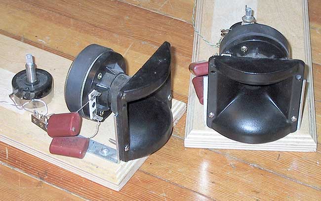

The horn tweeter we used was actually some generic import . I think I've still got the box in my workshop, and Dave can certainly post a picture of same. Actually a very nice sounding little horn, although I never proceeded past the cheap XO parts - I bought the 108's instead.

Here is a pic of the MG tweeters... i'm pretty sure you've seen my tweeters of the week page
http://www.t-linespeakers.org/FALL/bd-pipes.html
Horns tend to work pretty well. I speculate that their narrower dispersion is a better match way up where they are working...
dave

If you are going to use a dome, or a variation like these nominal 14mm domes (the 10mm are better), try loading them in a waveguide...
dave
