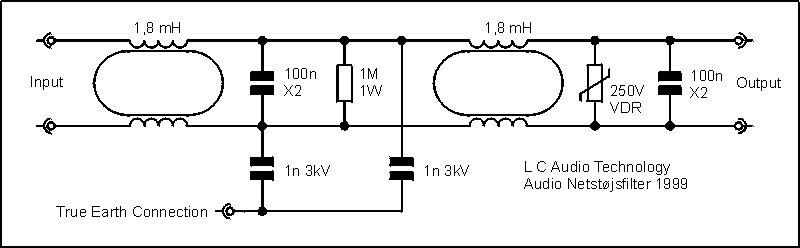

I checked LC Audio site and Mains Filter seems to be interesting. What is 250V VDR in the schematic?
VDR stands for "Voltage Dependent Resistor". These components exhibit a large resistance until the voltage accross them rises above a certain threshold value, when their resistance falls rapidly.
VDRs can be connected across the mains like this to absorb any large spikes, helping provide a cleaner supply. Normally they have a quoted maximum AC line voltage, so here 250V is presumably intended for use with a 220-240V supply.

Essentially a Varistor I assume.
In the US they're called "MOV", Metal Oxide Varistors.

LC Audio soft start circuit is based on 220V operation. You can see IN and OUT connections on the board. Being pretty dedicated module with digital delay it might not work properly with 110V. As always in cases like that, the best is to contact the manufacturer and ask them directly.;)
Hi Peter.
You are absolutely right, I have noticed the same thing and will check with manufacturer if they have any options for 120V for us. I will let you know as soon as I find out something more.
Yes, VDR stands for "Voltage Dependent Resistor" or varistor if you wish.
