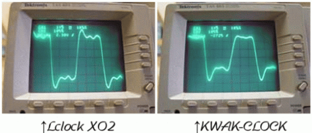

I ha ve just implemented a Kawk clock 7 on a home made PCB.
In my measures I experience a "big" undershoot and some "ringing" in the low cycle.
What is causing the undershoot?
Is this due to a design error from my side or is it supposed to do that?
If it is error, any idea where the error might ?
How about rise and fall times? i measure appr. 2 ns fall time and 6 ns rise time (22.5792MHz oscillator). Is this a trimming issue?
I will try to get some printout from my measure if it would help.
Thanx!

Hi Niklas, Don't worry too much. The ringing may be due to the measuring setup. Even the duty cycle adjustment is not critical as only the rising edge is used by then CDP.Niklas said:Hi!

If it is due to the setup, you should see symmetrical ringing. Otherwise it is due to the circuit.
This does not implicate it is bad but I see it more often, for example due to asymetrical output impedance.
By the way, some converters convert at the falling edge. I've seen DACs where the jitter on the falling edge was significantly higher than on the rising edge......

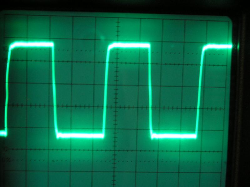

Hi guys!
You say falling edge usually look worse than rising edge.
I must say my falling edge looks better then my rising in a jitter type of view. I must say i am pretty unexperienced with digital clock signal so maybe i am wrong.
Though, using my tektronix scope with Instavu, I get a more "spread out" rising edge, and a very thin falling edge. From that i draw the conclusion that the rising edge is more jittery (made up word maybe??).
As far as i know the sampling instant must vary much more for a slow rise time than for a very fast one.
I will try to get a print out to illustrate what i try to explain, a picture says more than 1000 words =).

If a short 50 ohm coax cable is used to connect directly to the scope, and the 50 ohm resistor at the output IS present, no ringing can be seen. At least in my setup, AD8611 and AD8561 devices /the first one has higher SR/lower tranzition time/, double-layer PCB, 100nF+10nF decoupling next to the chip etc.
The circuit is great /and simple /

YES, I experience similar ringing differences, but they are due to the scope probe /the ringings/ and due to different slew rate /the difference between rise/fall/Elso Kwak said:

Niklas,
Don't worry about digital circuit. It is actually fairly analog here.
A rising edge is a driver charging current into a capacitive load
when falling edge is discharge from the load through the driver
to the ground. Intuitively, it is easier to discharge than to charge.
And this happens to be true in most real world cases.
Look at KC7's final output stage, it's a comparator. A comparator
is usually optimized for the best timing performance (
so people can use it for clock recovery, for insance).
This translates to fastest possible rise time and fall time.
The designers do not care whether the waveform is symmetric
or not. Here is AD8561's datasheet:
http://www.analog.com/UploadedFiles/Data_Sheets/764437034AD8561_0.pdf
you will see the fall time is more than 2X faster than the rise time.
This is the main reason why you would see a much sharper
falling edge on the scope.
As for LClock2, it uses CMOS inverter as the output driver.
CMOS inverter itself is a typical symmetric design so
you will see a much more consistent rise and fall time.
Still, the fall time is usually 25%-50% faster than rise time
because NMOS is faster than PMOS.
KC7's design has many merits. There is no secret about
why it sounds better. Still, it is a good idea to get a PCB
from Elso to see how the layout is done. For high speed circuits,
layout is everything.

Given this picture I conclude that rise and fall timeas of KC are about the same. Hence no explanation for undershoot.
Understand me correctly, I am not saying is is good or bad, though over / undershot potentially affects the timing.
Attached a measured result on one of TentLabs 11.2896 MHz clocks.
cheers
cheers

Perfect Square Wave Output
Firstly I want to mention that I have not tested all clocks (Kwak, LC, Tent) under all conditions. And since I have not bought any one of them, I have no preferences for any.
A friend has sent me a Tent clock 45MHz, which I measured with 5V battery supply, a 47 ohm series resistor followed by a 5k load, and a 1 GHz digital oscilloscope. I can confirm that the output waveform also has overshoot, very similar to those as shown in tvi's post.
Guido has kindly confirmed that the XO is OK and the perfect square wave as he posted can be obtained using a 50 ohm load after the 47ohm series resistor. I am puzzled however which DAC loads an XO with 50 ohm, and would the resulting amplitude of the square wave then not be halved, i.e. 2.5V pk-pk from a 5V supply.
I am out of town for 2 weeks, so unfortunately have no access to the data I measured.
Patrick
Patrick

Re: Perfect Square Wave Output
Hi Patrick,
The Tent XO inside, same as many other XOs, has one IC
which takes care of almost everything. This IC is CMOS based so
as I have explained above, it will generate a symmetric output.
But how it will perform in real circuit is another story.
This depends mainly on the capacitive load of the next stage,
and to a less extent, the load impedance, when hooked
up with a CMOS driver.
You can treat XO as a current source. The lower the load impedance
is the better. Sure, the voltage limit will play a role here, too.
Older DACs are bipolar based when latest ones are mostly
in CMOS. They will behave differntly so my suggestion is
not to worry about the undershot too much. Usually it does
no harm to the DAC performance. Sometimes people will
add in fast logic buffer, say, 74VHCU04 between
XO and DAC. This logic will do the impedance matching
as well as isolating XO from the change in load condition.
-finney
