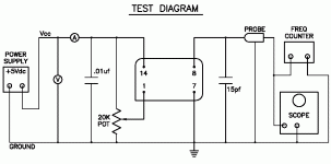

Hi Guido
Let me keep it simple, too. Looks like your analysis is more based on the quiescent state when my focus is on the active region. Yet remember the main focus here is the shape of the waveform. Since you claim the larger load impedance the better, why don't you hook up your XO with a 100K ohm load and a 40pf cap in series to see how it goes? Why did you tell Patrick to add on a 50ohm resistor instead of a 10K one? BTW, many XO companies simply load the osc's output with a 15-30pf cap to do the testing. They must love to test the worst case scenario?
Talk about XO companies, Allan deviation is a widely adpoted measurement for stability test. It strikes odd to me that you are not familiar with Allan deviation but claim stability has nothing to do with jitter?
-finney
Attached diagram is a typical setup for XO test.
