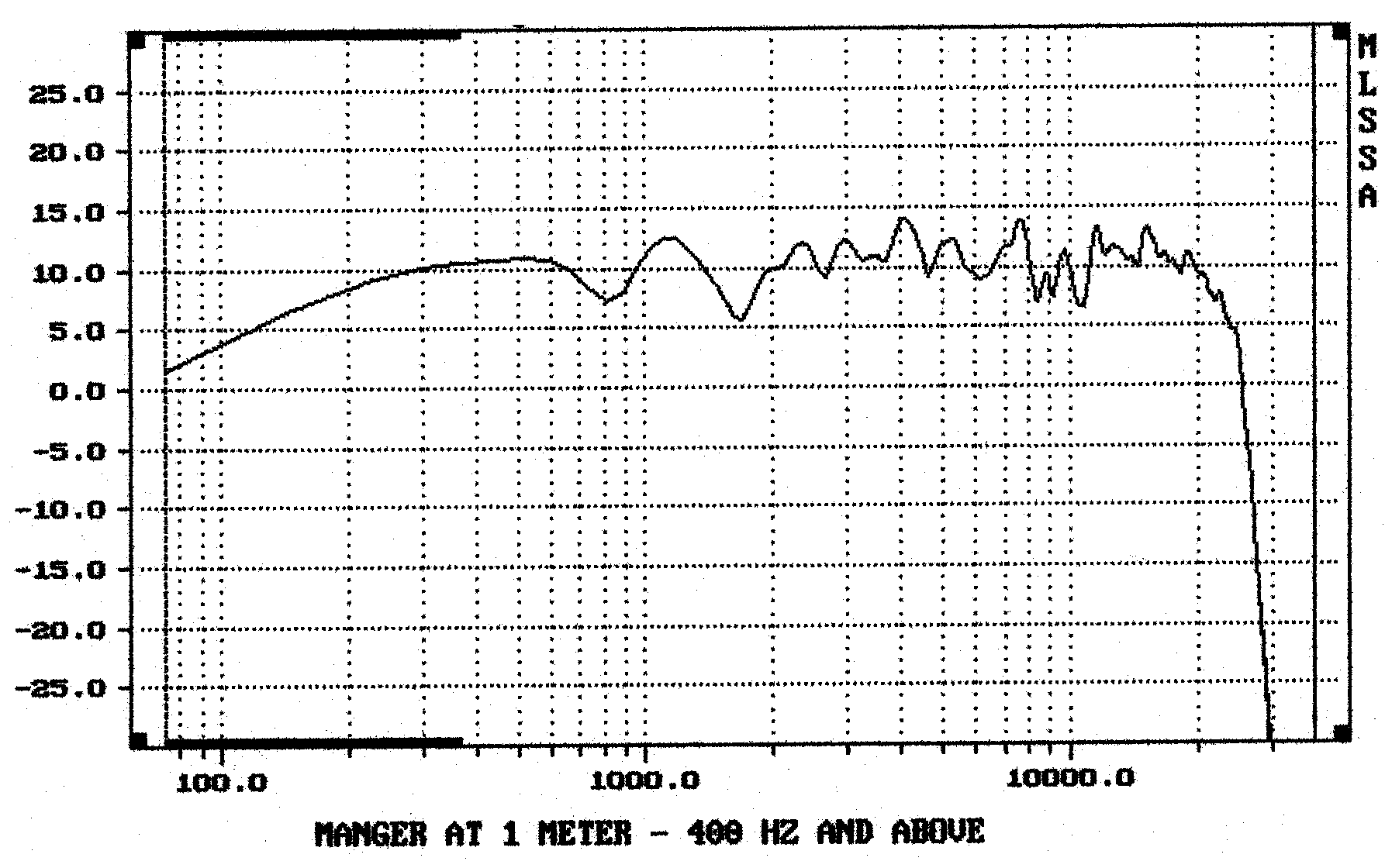

I've used them. They are good full range drivers, measuring
quite well, but not particularly efficient. They have two voice
coils, apparently nearly identical and designed to be driven
parallel, as they are about 15 ohms each.
The fundamental resonance is about 80 Hz.
The sound is fairly neutral, although not as apparently dynamic
as the higher sensitivity Lowthers or Fostex - more on the order
of Jordans.
And they are expensive.
I am posting a 400 Hz + curve.

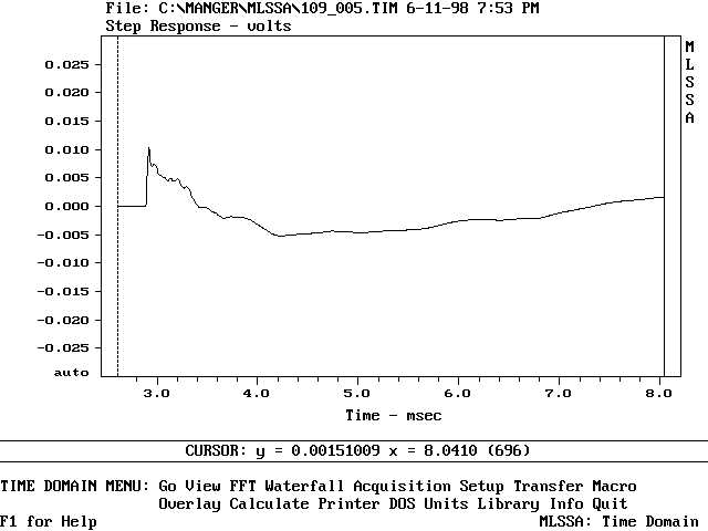

ScottG said:However the belief that the driver's dynamic time domain performance would cause a "dull" or less "dynamic" sound is in error. While "transient noise" (or dynamic time domain errors) are certainly a distortion, they should not cause the aforementioned subjective effect. Nor should static time domain errors cause this effect, (errors seen in a cumulative spectral decay).
"Should"?
ScottG, in your experience, how do time domain and transient speed affect one's subjective perception of the sound? More particularly, in what terms do you describe the sonic difference between a driver, such as the Manger, having a 13us rise time and a step function as on the attached graph, and a typical cone or dome driver having a much slower rise time and an identifiably different step function (see almost every edition of Stereophile)?

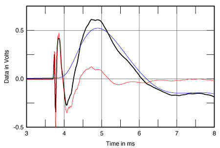

My Manger 109s replaced a well regarded (Swiss) ribbon/cone speaker in my system costing >3X the Manger. My girlfriend, who only amusedly follows my audio related meanderings, said about the Mangers, "wow, are those ever clear .... I really like their sound." (Why are not more women in high end audio .... would have prevented so many wasted diversions into ridiculous sounding amps/speakers/source components. OTOH, I'm not surprised to see a woman at the helm of Manger.) This "clarity" about which my girlfriend remarked likely speaks to the Manger's time domain and step performance, which I suspect to be the source of jcarr's comment that the Manger driver is "quiet."
The interesting point, here, is why the Manger sounds so different from a first rate ribbon---and IME subjectively cleaner. Driver mass evidently is not the determining factor. Nor is dispersion, as my ribbons are more directional than the Mangers.
What are we looking at here? What part of this is the ribbon...just the first up/down spike?serengetiplains said:Here's the step response of the ribbon speakers I own, which have a 0.15ms rise time.
