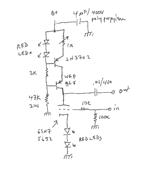

You might check out the linearity tests that Morgan Jones did. Using a common-cathode circuit biased with LEDs and an 8ma CCS plate load, his results show the 5687 to be somewhat inferior to various 6SN7 types.
I've used the C4S and Pimm BBMCCS in a number of designs and like them, BUT, they sound very different than R, L or Tx loads and you might not like the sound of them. High end audio is about finding the flavour of sonic presentation you like, and some people like these, and some don't. I'd suggest trying and seeing; they're not really expensive on parts.mark_titano said:Hi all. I've a pair of 5687 and I want to try to build a preamp loading the tubes with a ccs. Does someone tried to do something like this? Where can I find good ccs shematics for this purpose? And which is the best operating point?

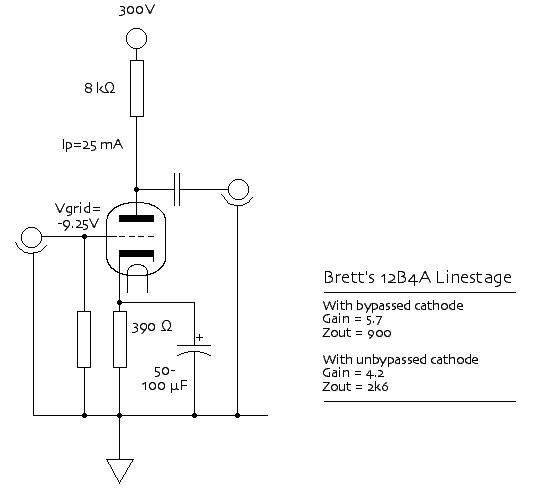

CCS fed shunt regs are excellent, and I think I'd have the whole system run this way if I could. I use a superreg in the phono preamps, but ditched the 317 based CCS in the original design and used a BBMCCS. Didn't think there's be much difference, but there was. Also tried the same setup in the front end (drivers) of various poweramps and it was great too. Ditto all of this with the CCS/VR tube regs, but not as quiet as the superreg, though cheaper, and better in poweramps I'd say.
For a preamp that's going to be fed mainly by a CDP I'd rather use a 12B4A.
To my ears and mind it's far better suited and doesn't suffer the rather darkish colourations of a 5687 being pretty transparent.
Do have look around at this forum, Brett shared a nice schematic a while ago.
You can of course add a CCS (can't remember if there was one in Brett's design).
Cheers,😉

Agree about the 12B4A. My schem has resistive loading, but it wouldn't be hard to modify. Just slap in the CCS and heatsink adequately. A lower B+ would also be possible, say 220-250V.fdegrove said:Hi,

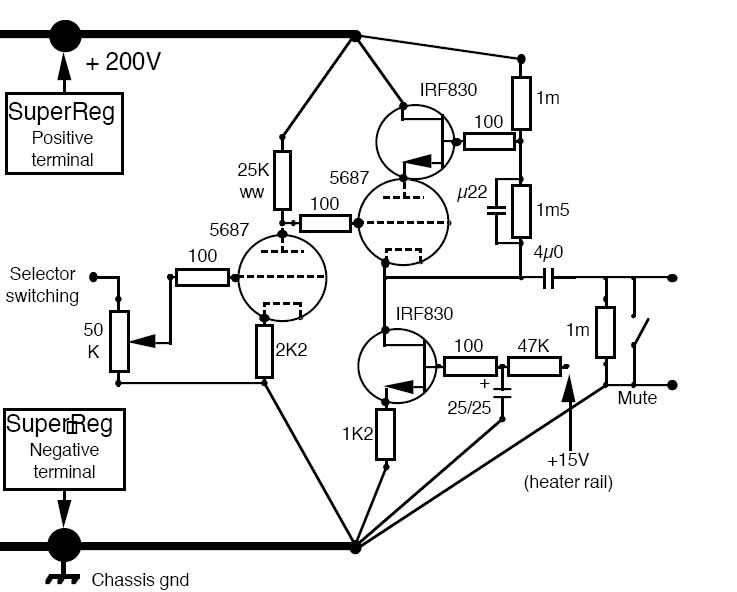

For the first one, have someone tried this design in the bottom? I've found it on vacuumstate.
For the power supply I like to try a CCS fed shunt regs, can it be a good idea or not? If not please teach me why

Allen's stuff is superb... the SuperReg shown is a CCS fed shunt reg and is an essential part of the circuit.
You can learn a lot more about this in his Preamp cookbook (an enjoyable read even outside of the audio goodies in it)

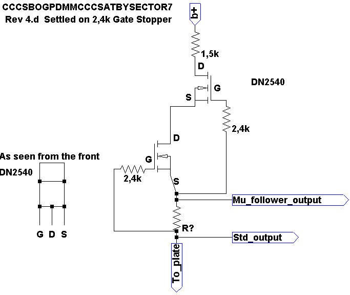

Here's the circuit I used. Note that this if for test jig purposes (where it worked quite well!), not for actual use in my audio system. My motivation was to extend some of Morgan Jones's excellent analyses to a few new tube types. Parts choice was only loosely tied to optimization- basically, I used what I had on hand.
