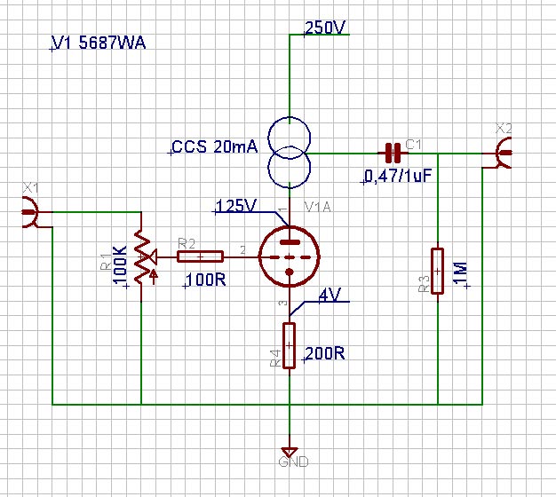

Thankyou very much to all of you.
I've read the Gary Pimm's article with more attention. I've trascured some things.
Gary suggest to use a mu follower output and write:
"It is interesting to note that only the circuits using the mu output have the triode operating in true constant current mode. In the other variations of CCS loaded triodes where the signal is taken from the plate, the plate current varies in proportion with the load current."
Now, I will take the SY circuit as an example. If I'm right, I can't do a mu follower output using a PNP transistor in the ccs load. In this case I have to take the output from the plate. :confused: The solution seems to use a NPN transistor, but, if I use a led to polarise it, I'll have current that flow from the reference chain to the plate and this is a bad thing ( thankyou Ec8010 ;) )
Maybe I can use a special led like this or maybe i can polarize the transistor with a battery, like Pimm do with his mosfet cascode.
http://www.fairchildsemi.com/ds/HL/HLMP-K150.pdf
Mu follower or simple plate output? Battery or special led? I like to know your "Guru opinion" about these different possibilities, maybe with an explanation of your chosen

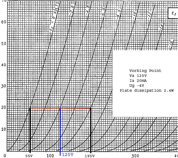

I look the graphics to find the working point for the 5687.
I attach the working point I choose...what do you think?
If I'll be able to make the tube work in constant current mode, the distortion will be very low. The max plate dissipation is 3.75W for each section, with 2.4W I think I can be comfortable :D .

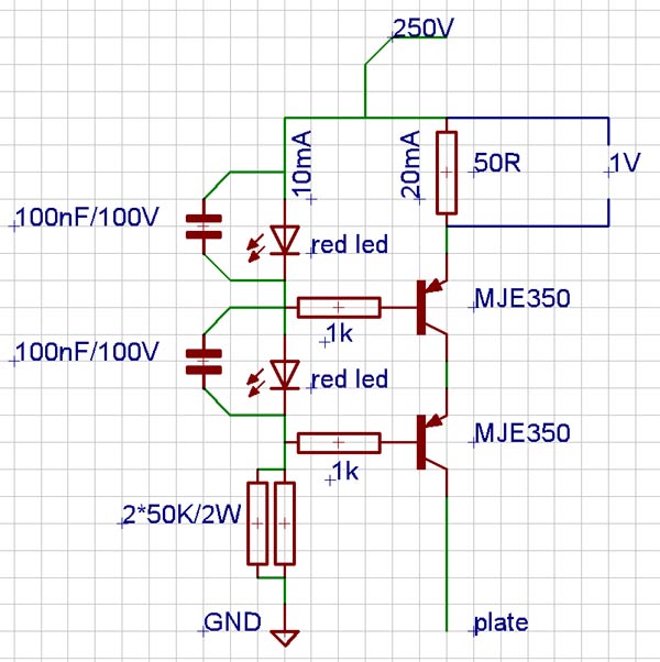

And now the MJE350 cascode...
My doubts:
1) in the datasheet I see that the Hfe is from 30 to 240...how can I calculate it precisely? In the datasheet there is an dc current gain graf, but it seems that the curves are plot in function of Tj,Ic and Vce.... too many unknowns for the poor documentations in the datasheet.... However,the plate have to see a load as greater as possible, right? To do this the resistor in front of the first MJE have to be greater as possible...so the voltage across it have to be the greater as possible. How much this voltage can be high? I can obtain it putting in series two or three led. For a mosfet there is a limit for the Vgs ( 20V). For a transistor exists a limit for the Vbe???
2)Instead the resistor on the base can be a good solution if I'll use a ferrite bean? This can limitate the oscillation in RF perhaps...
3) the current in the reference chain is too much high for a 1.65V drop? With 10mA the Ib isn't a problem indeed....

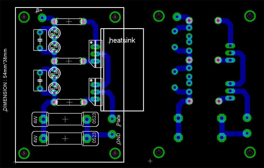

This is the fist bord for the "ccs MJE350 cascode". This is my third pcb, I've read some articles about the design rules but, once again, I have not experience... If it looks good I can post the eagles file...;) I hope this can helps those who wants to try something like this. And now I start to draw the mosfet ccs board.
In the board I've drew two led to polarize the transistor, the values in the schematics at post33# are for a single led ;)

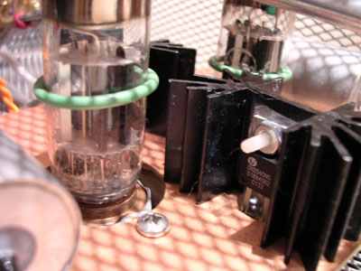

I'm certainly not a guru - I just follow the recipie :D I cannot comment on your irf830 design, I'm not wise enough.
I'm using Siliconix DN2540 mosfets - no biasing batteries needed. It may not be apparent in the photo, but they are physically supported by the heat sink, with one mostfet on each side. The legs of the chips hang down and I tie 1/4 resistors on, BEAM-style. The rest is wired point to point.
Be aware that the glass of the 12B4G runs relatively hot. Radiant heat from the big filament current, I think.
Cheers, Andy

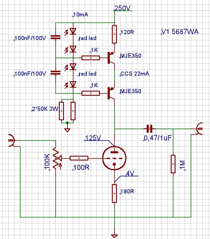

I start to make the version with the mje350 ( I can't try a mufollower output but I want to start with the simpler circuit just to understand how it works). I'm only waiting that someone comments my design...here the new schematic

Hi pedroskova, thankyou for the schematic.
This my first DIM ("do it myself" :D) attempt, so, nice to see I'm not far from others solutions ;)
I'll look for the LM329 and bc327 datasheets, I don't know them.
I suspect that the Lm329 is a 7V zener...infact to have 20mA trow R=R5+R3=320R I need something like 6.4V ( for a transistor I assume a Vbe=0.65V).The oscon cap is there to limitate the noise...obviously I'm not sure at all, in this moment I'm only an apprentice :D
What I don't understand is R10. Why do I need it there? To prevent oscillations? Doesn't create non-linearity to the load? When I have a voltage drop in the tube, the resistor doesn't make the current stability across the tube worse? This is only a question, not my point of view, I've never try something similar, I only want to understand :angel:
Mark
Mark
Actually, I don't know what it does. :xeye: I just use the basic C4S without the added diode, cap, and resistor.

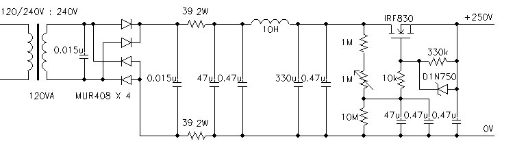

Just to muddy up the waters further,
here's another variation and discussion from Kurt Strain :D This is the image he's referring to.
