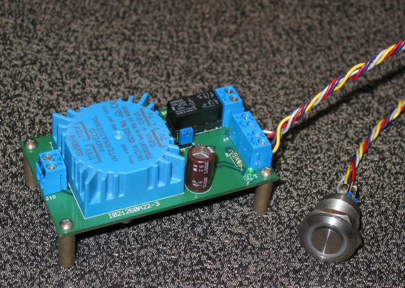

I've designed a small board that's used as a soft power switch in my Leach amp. I had to order a minimum of five boards so I'd like to offer 3 of them for sale.
The PWB contains a PC mount AC transformer, JK flip-flop, switch debouncer, and relay to switch 115VAC to a device(s). I use the output to drive a solid state relay that powers the main torroid transformer.
I'd like to offer the kit for $20 shipped with all parts except for the switch, relay, and transformer. The switch I used is pretty fancy and has a built-in blue ring to indicate power is on.

If there's really enough interest I can order more boards. The switch and transformer that I used makes this sort of expensive for what it is, but it's done in a very neat package and looks nice.
Since I didn't mention it before, the PWB measures 2.0" x 3.5".
If I can get a total of atleast 8 orders (3 PWB's that I want to sell + minimum order of 5 PWB's from vendor) then I'll order more boards. After the 3 are gone, I'll order more if there's enough interest.
-Rob

Nope, that's not at all what this circuit is intended for. I wanted a momentary push button for my power switch with an LED "ring" to indicate that power was on. I was prepared to make a lightpipe around a regular push-button switch when I stumbled an off-the-shelf switch that did exactly what I wanted. I'm using a JK flip-flop to toggle power on and off, clocked by the switch. The switch needed to be debounced and I also needed some drivers for me LED. So to simplify things I made a PWB that contained all this as well as the power transformer.
Hence the name soft power switch.

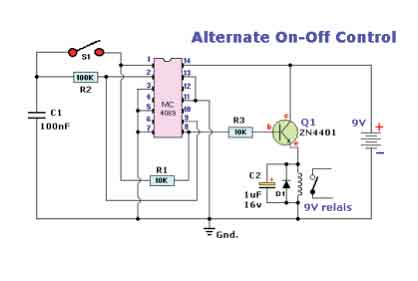

Hello Rob, can you show a schematic ? Too bad you did not include a jumper for use in 230 V areas ( I saw you used a transfomer with dual 115 V primaries ! ) 😉

I have installed a Vellerman kit in my BOSOZ pre-amp to solve the turn-on thump problem. I have wired the output relay the way you have described it. I was wondering which circuit are you referring to. Can you post a schematic too?

Here's the schematic for the circuit. I was too lazy to build a part for the debounce IC so I shows up as a 4-pin jumper. There is only 1 decoupling cap that is shared by the flip-flop and debounce IC because of the close proximity of the VCC pins.

how much per board ? what comes with them ? what is the max curent that can be use.. I am assuming that depends on the relay ?
JasonL said:how much per board ? what comes with them ? what is the max curent that can be use.. I am assuming that depends on the relay ?
$20 each shipped. Look at the first message in this post. I list the items that are included. The output of the board is the AC line voltage (115VAC) and is switched through a 1A relay. It is not suitable to switch a power transformer. You will need to use either a 115VAC input solid state relay (like I'm doing), or tap off a 5V switched output for the LED.
