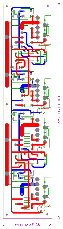

the PCB lay out is a pretty crazy DIY things for me😀
this is my BPA200 projects,the chips +/- rail and ground track has not finished yet,any suggestions??
the sch is based on the original BPA200 article,use DC serv.and the amp pcb is not including the push stage.

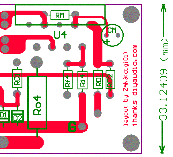

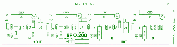

because those 3886 chips need to leave certain distance.it happens that there is space of serv parts on the boards,I put it.
I think it's wise to provide the board space for serv circuit.If you do not like the BPA200 work at serv mode,just leave the serv chip socket empty.

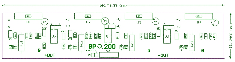

digi01 said:optmize version,including input buffer.
the pdf file show top and silk layer😉
Do you not have ANY psu decoupling caps on the mainboard?😱
The main board was not set up any bypass caps.I have leave a series holes near the chips for mounting the mother rails of power supply.
digi01 said:ver#1.0 source share.
try upload my BPA200 gerber files.can anybody give me a rank😀

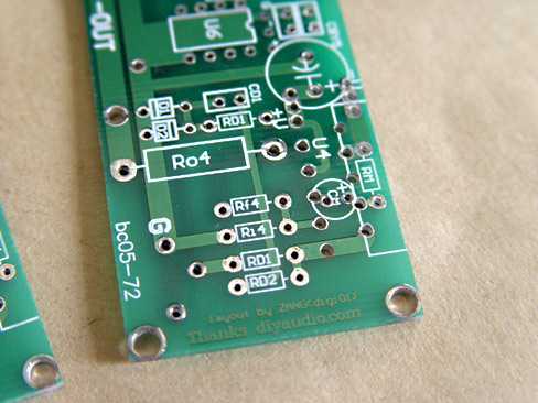

Re: I would wish view your pcb for BPA200
I have not manufacture the board.I accept pre-order(over 20PCBs)then I will work them out.
the attached photo is the final board silk layer,double side board,160x33mm.you can build BA100/PA100/BPA200 AMP.
if you have interest,can drop me a mail.

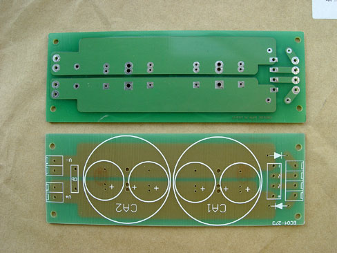

I have got the boards a moment ago😎
the upper thing of the photo is a chinese pencil😉 the PCB size is 160x33mm.
