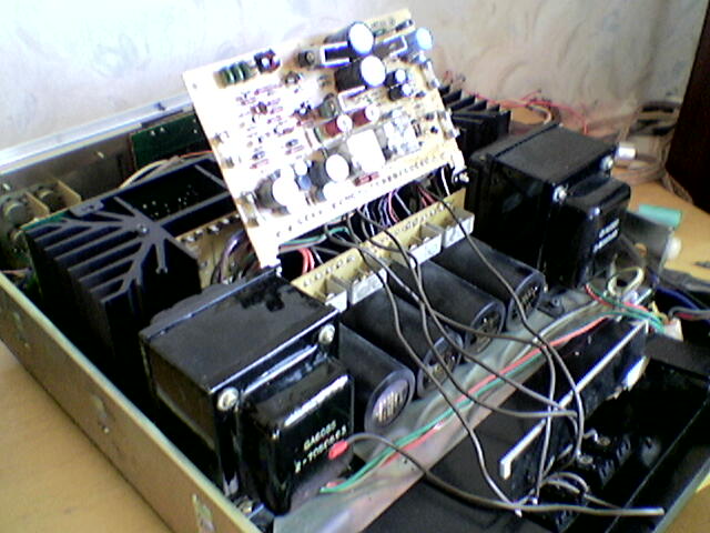

BtW I hooked this one channel to dynaudio diY speakers(mw 170, tweeter - ribbon, x over at 4khz) yamaha for a longer time- looks like it was conected long time ago. what can I say.. the sound now is mych better, it has some very interesnting openess in midrange, an has incereirble HUGE macrodynamic, very fast and powerful and at the same tie subtile sound.
pretty sad to take in parts this beauty- silver colour mint..
two v-fets is probably good in dead chanel- I suppose can not repalce only two(there are 4 per chanel) dead?
how about sound qyality if repalce with ordinary mosfets ,and what sugestions about it? irfp 240 will not fit.. 🙂
also I am thinking of selling this heavy thing, for somebody near lthuania. , europe, because it weight 28kilos.

yamaha inside
looks pretty good comapring with pass labs aleph 5 or 2..
good quality nichicon with gold plated letters
