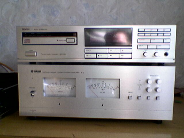

any info,manual about Yamaha B-2 ?

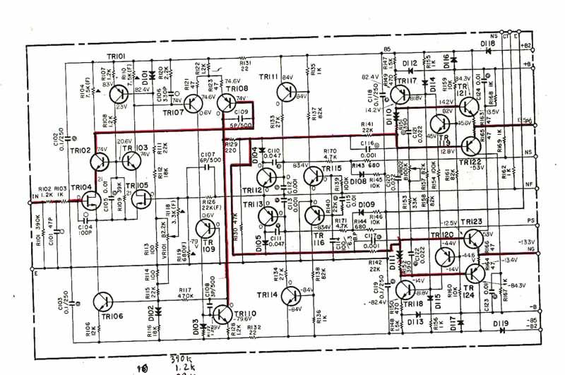

also if this is is not a big problem I need schematic (not whole manual) to calibrate bias and read voltages.. if its not very many pages Could you scan it?

Here is the inputs predriver and drivers board. the bias voltage is 13.3 volts. The would make changing to MOSFET very difficult.

FYR!
TR101: 2SA872A
TR102, 103: 2SC1775A
TR104, 105: 2SK43
TR106: 2SC1439 B or V
TR107, TR108: 2SA810 B or V
TR109: 2SA810 B or V
TR110: 2SC1452 B or V
TR111: 2SA872 BV
TR112: 2SC734 O or Y
TR113: 2SA561 O or Y
TR114: 2SC1775 BV
TR115: 2SC1775A
TR116: 2SA872A
TR117: ?
TR118: ?
TR119: ?
TR120: ?
TR121: 2SC1452 B or V
TR122: 2SA810
TR123: 2SC1452
TR124: 2SA810
OUTPUT : 2SK76 X 2 & 2SJ26 X 2
He can't. Because I bought it (it didn't sell at $350 so I got it on the relist). And it is every bit as wonderful sounding as elviukai thinks it is. I have been A/B listening to it and my much newer bipolar output stage Yamaha MX-1000 and the B2 is clearly a better sounding amp. As a result I am selling my MX-1000. Guess I'll keep my fingers crossed about finding parts.

You might be able to find the N channels FET's but the P's look to be a different story. I have the power supply from one of these amp in and old preamp I designed. Anyway, the page I left of the shematic is all you need. I have the rest but it's a hassle to scan then it reduced to the correct size for the board.
