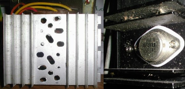

I am trying to post an attachment with this. It is a picture of the heatsinks.

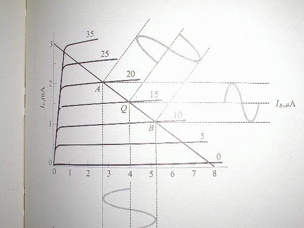

Ah, well, I'm not too familiar with tubes although sometimes I wish I was. I doubt I'll get obsessed with the "tube sound" but they just seem fun to play with.
Anyway, a Vc vs Ic curve would depend on the collector loading. What you're really asking is probably: Ic vs Ib curve since a BJT is a current focused device. And that curve is very dependant on Beta which is completely not a controlable factor. You're better off being aware of what the curves kind of look like and then making sure you stay in the fwd-active region. Mostly you want to try and work around beta as the gain factor in your circuit. gm = Ic/Vt and Av = -gmRc for a CE amp.
1-amp, 15-volts = 15watts dissipated. That heatsink may do it, bigger is better... I found that my first time doing a zen, I way underestimated my power consumption and heatsinking needs. Bang-for-buck your best bet is to go to a computer parts store and try and find a cheap, obsolete Athlon heatsink to start with.

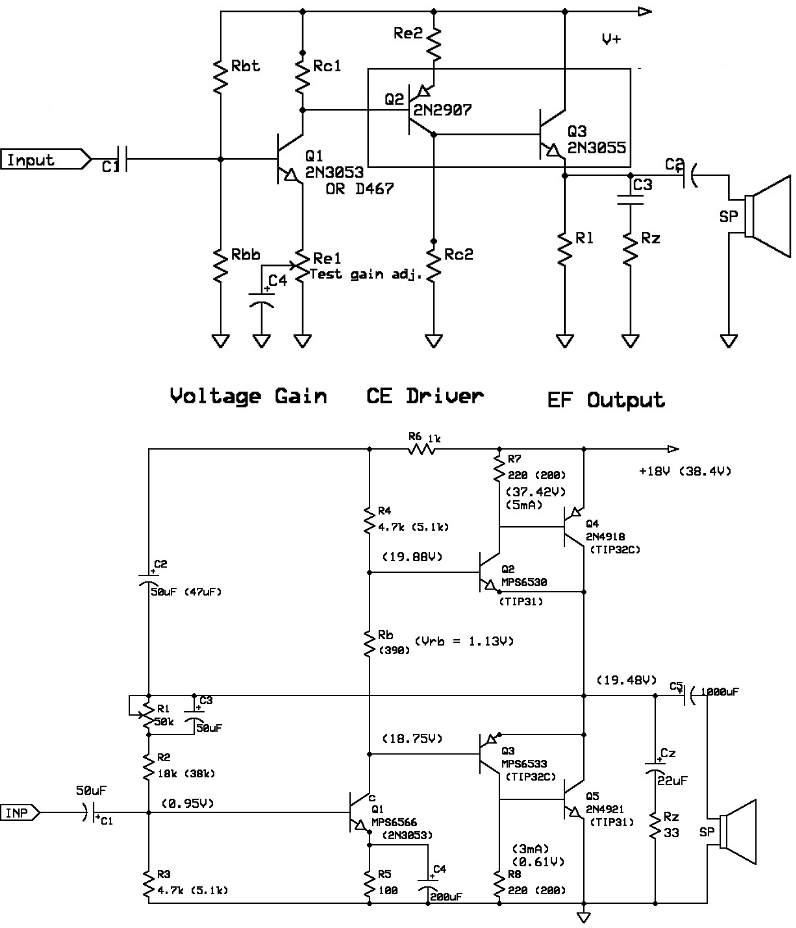

Here is where my head is
Jonathan, thanks for the tip on the JLH. I will check it out.
I thought that it might be useful to look at a couple of circuits. The top circuit in the attached jpeg is a priliminary sketch of my thoughts for the class A amp. The bottom circuit is the current state of a class AB prototype on which I am working. I am including this second circuit so that you can get an idea of from whence I am coming. I would welcome comments on both circuits (and my interpretation of them). Please be gentle... I am trying to learn here.
The Class AB Amp:
this is a modification of a design from an old text book. The values in () are the actual values as I built it. The indicated voltages are actual measured values in the prototype. Just noticed that the schematic shows R1 = 50k pot. This has been changed to 100k. Note that the original design used two diodes in place of the 390 ohm bias resistor. I was having trouble getting the right bias with the diodes and so I switched to a resistor (I was using rectifier diodes which may have been the problem). When everything else is sorted out I will probably try using signal diodes (or a single diode with a trim pot).
As it now sits the prototype idles very cool and when played quite loudly the heatsink gets warm but not at all uncomfortable to touch continuously. It sounds fairly good at moderate to high volume levels. If I drive it with a signal low enough that I have to put my ear right up next to the speaker to even hear it I hear some static like distortion (cross-over distortion?).
Given that the amp idles as cool as it does and the distortion at very low signal levels I suspect that I might be more like class B at this point. This may not be a big deal since it will be used as a utility amp for an electronic keyboard but the goal is Class AB.
I am also concerned with the low voltage at the base of Q1 since this will limit the input voltage headroom. I am able to drive it to a nice level with a cassette deck but I would feel more comfortable with a little more voltage swing. I did not increase R3 very much from the original design and I probably should double it to get a bit more headroom (and better Zin) and then readjust R1.
I also note that I could have (should have?) used small signal devices for Q2 and Q3 but the TIPs were handy and I thought that the extra current and power capability would give me some extra leeway. I may change them out and use the TIPs to make another identical channel.
One thing that I had trouble with initially was understanding the purpose and operation of C2. The text book claimed that it was used to decouple the PS by bypassing R6. Now it doesn't look to me like this is the case at all. From other reading that I have done I think that it is used to bootstrap R4. Am I off base here?
The initial circuit did not have the Zobel. I threw that in when I thought that I might be getting ultrasonic oscillation (I still am not sure and I don't have a scope to check it out).

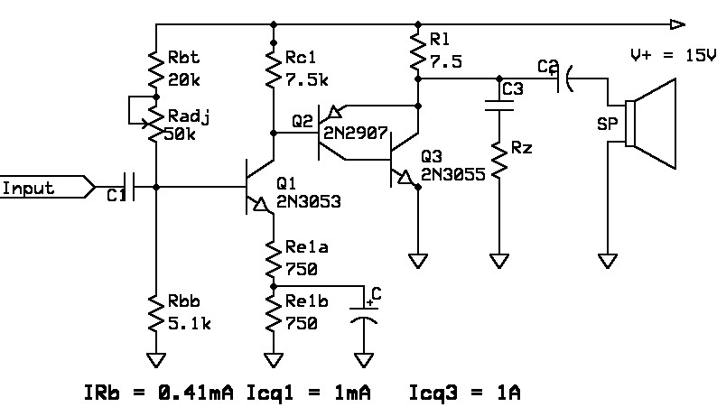

The Class A Circuit (V+ = 15V):
Now be kind... I am doing this in order to learn remember. 🙂
Since this is a learning project I thought that I would try something a little different and use an EF output stage and build the first version with no interstage feedback. The circuit shown is my first concept of what it would look like.
Icq3 will be set to approximately 1A. From 2N3055 data sheet hFE@Ic=1A@25deg.C is 90 ==> Ibq3=11mA so Icq2 should be about 100mA to prevent excess loading by Ibq3.
The first thing I notice is that Vcq2 will be (V+/2)+ 0.6 = 8.1V in this case. Now the maximum input to Q2 will be limited by the Quiescent voltage across Re2 which is limited to substantially less that V+/2 due to the requirement that the C-E junction remain reverse biased. This should be OK as long as we give the Q2 stage sufficient gain to bring this up to near the supply voltage(???). Will I be able to get a gain of about 5 in the Q2 stage while still being able to deliver sufficient drive current for Q3? Would I choose Re2 such that Veq2=(V+ - Vbq3)/2 or should I use higher voltage gain in Q2 (and lower Vdrop in Re2) so that I can maximize Vcq2 swing? As you can see I am a little bit confused on how to optimize this.
My initial impulse was to collapse the Q2/Q3 stage into what I would call a complementary darlington pair (like a darlington but using PNP-NPN pair) but unless I am missing something this appears to be impossible with an EF output stage because of the severe limitation on the input voltage (Q2 emitter is at V+). A true darlington using 2 NPN devices possibly?
The pot connection of C4 is for prototyping purposes so that the gain of stage one can be adjusted.
So am I totally out in left field here? Barking up the wrong pole?

That would be called a "CFP" or complementary feedback pair. It's a pretty common type of output stage. While most used strictly for output stages try to create unity gain, there are versions that actually have gain. A CFP wouldn't be a bad idea to try, it looks similar to what you're doing now anyway. So a search on CFP or sziklai pair for more info.

I did as you suggested and googled around a bit. It looks like the load resistor would need to be on the emitter of the first transistor in the pair (I was trying to put it on the emitter of the last transistor).
So are we talking about something like this? The attached file is my stab at a Sziklai output. If I understand it right hFE of the pair is hFEq1 X hFEq2 so that Q1 could be a small signal device and only Q2 would actually pull large current.
Does that look like a workable design? I am not entirely sure about the stability of the bias currents.

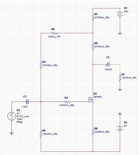

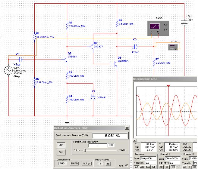

Thanks Millwood!!! That is really going the extra mile. This gives me a great starting point. When I get the Sim that Geoff recommended up and running I can use your results as a guide to whether I am modeling it properly. Once I have the basic model down then I can play with the circuit and see how good I can make the circuit without interstage FB. At that point I can decide whether to use additional feedback, howmuch and where.
Did you happen to notice during your run whether the circuit was getting enough gain to reach the full potential of the 15V PS and/or if there was any excess gain (could bypass less of the 1st stage emitter resistor in an attempt to improve THD)?
It might make sense for me to model the input stage by itself to see how much it contributes to the total distortion.
I sure hope I can get this sim software up. It could be a whole lot of fun and very educational.

millwood said:well, I did it for you. Here is the simulation results from multisim.
I adjusted R1 to obtain the best output. THD pretty high, at 6%.
Try to add some small resistor between the emitter of the 2N3055, and the ground. It will set some local feedback, and increase the linearity.
