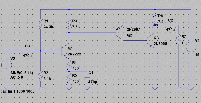

I did as you suggested and googled around a bit. It looks like the load resistor would need to be on the emitter of the first transistor in the pair (I was trying to put it on the emitter of the last transistor).
So are we talking about something like this? The attached file is my stab at a Sziklai output. If I understand it right hFE of the pair is hFEq1 X hFEq2 so that Q1 could be a small signal device and only Q2 would actually pull large current.
Does that look like a workable design? I am not entirely sure about the stability of the bias currents.

sajti said:
Try to add some small resistor between the emitter of the 2N3055, and the ground. It will set some local feedback, and increase the linearity.
sajti
I am not sure. the amp has a compounded pair configuration in the output stage and the "emitter" resistor for the pair is the 7.5ohm resistor sitting on the collector of 2n3055.
adding an emitter resistor to the 2n3055 may limited the voltage swing and adding distortion.

And distortion is very sensitive to the bias of the first stage: a couple of kohm out and you will immediately see distortion.
Are you talking about changes in the value of the top resistor in the voltage divider bias network? I am also planning to try running higher current in the bias network and using a bootstrap resistor to raise the input impedence.
from Sajti:
I think You have to change the whole topolgy. In Your amplifier the VAS stage has very low output. You can apply other type output stage, with voltage gain, and some feedback, as well.
Possibly. I also have some options for increasing the gain of the VAS stage. My plan is to try to get the best performance I can before adding interstage NFB and then add only what is necessary. I also plan to look at bootstrapping Rcq1 as well as current source or cascode on Q1.
That sounds like a good idea. I imagine that a fractional ohm power resistor would be about right.

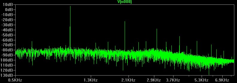

I was able to get LTspice working first so I did some sims with it. Using the circuit attached I got the DC operating point sorted out and ran a transient response on which I did an FFT (it took quite a while for me to figure out that this was the way to do it).
On the next two posts I will attach the resulting FFT and THD calculations.

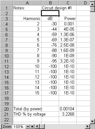

I downloaded a spreadsheet from the net which is supposed to calculate THD from the dB output of an FFT. The results are attached. This shows a bit over 3%. This is about what one would expect but is about 1/2 of what Millwood got so I am suspicious that I have done something wrong. :xeye:
The interesting thing is that I tried using various layouts including GNFB, NFB around VAS only, Current source load for VAS, Cascode on VAS and standard darlington output. In no case was the distortion reduced by more than about 1% (NFB) and whenever HD2 was reduced (max 3dB) HD3 actually increased.
Got to do some more thinkin'.

the fft calculation in ltspice (and others I guess) seems to be quite sensitive to how long you let the simulation run, and windowing. You may want to let it run a little bit longer (I did 100ms and got something that looks different from yours).
I also used perfect transistors (too lazy to use real ones).
Anyway, it should be directionally accurate but not exactly accurate. so take it with a grain of salt.

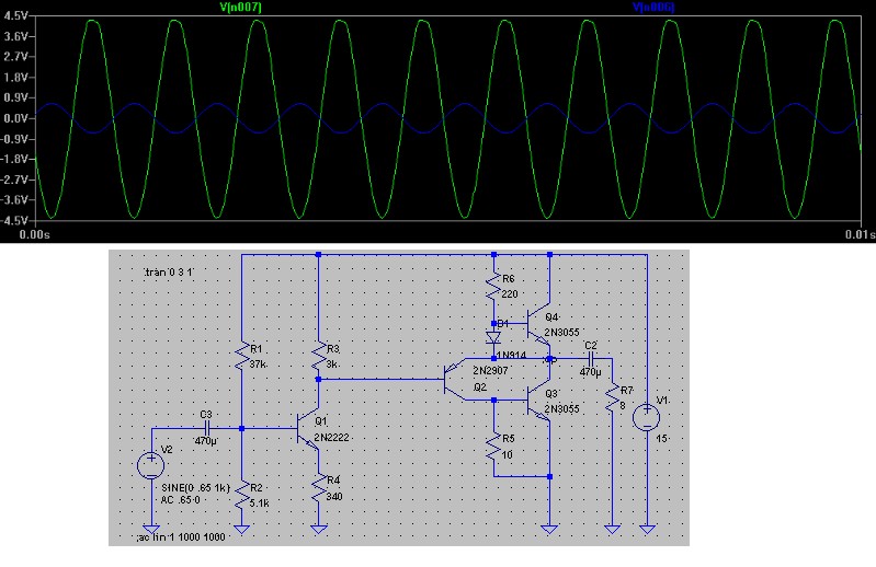

More complex
This circuit uses a simple current mirror to load the output transistor which increased the possible power output significantly. I show the diode version since I have lots of those on hand. It seems like one would not gain any advantage in using a transistor instead of the diode unless it was also a 2N3055. Is that an accurate statement or would it be worthwhile to use a small signal transistor instead of the diode?
Thanks to Henry Johnson for the idea of using the collector resistor on Q2 to increase the quescient current through Q2. You will also note that the current through Q1 has been increased and the emitter bypass capacitor has been removed. As the circuit stands there is enough gain to drive the output just shy of clipping with 1.3v p-p input. If slightly greater sensitivity is needed I think that Q1 can be biased for slightly more gain without any difficulty.

:xeye: I must have taken my dumb pills today. I was in the shower when it hit me. Take a look at that "current source". The resistor which is supposed to set the current is modulated with the output signal. :bigeyes:
I think what I need to do is change the transistor to a PNP device with the emitter connected to V+. The diode would then be connected to the V+ also and the current set resistor should run from the diode to ground.
I think that should work.
a npn current source like yours can work, with some modifications. Take a look at some of nelson's work: he had used n-channel mosfets as current source. i also simulated a similar design but didn't have much success due to thermal run-away. But it can be made to work.

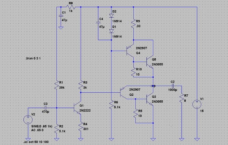

Latest Version
Many, many thanks to Halojoy who has been very helpful with the current source as well as other circuit details!
The attached jpeg is the current state of the design project. I have been toying with the idea of using choke loading instead of the CCS but I suspect that I will end up with something very close to this CCS design.
The simulation indicates that this circuit should give frequency response that is 3dB down at about 17Hz and 200kHz. If I remember right the power output was more than 6 watts. If I actually get that kind of results I will be very pleased.
Of course the PS shown is an ideal voltage source and using a real PS will effect the results. I may go ahead and simulate the actual PS as well but right now I intend to use an exiting 15V 1.6A PS that was salvaged from who knows what. I will put additional RC filtering on the amplifier board.
The circuit diagram shows all fixed resistors for the purposes of the simulation. Obviously the bias and current adjust resistors would have to include an adjustable portion. Also note that not all of the devices shown are the actual devices that will be used because I don't have models for all of the devices that I intend to use. Therefore some values may be somewhat different.
The values shown result in about 1 Amp through the 3055s.

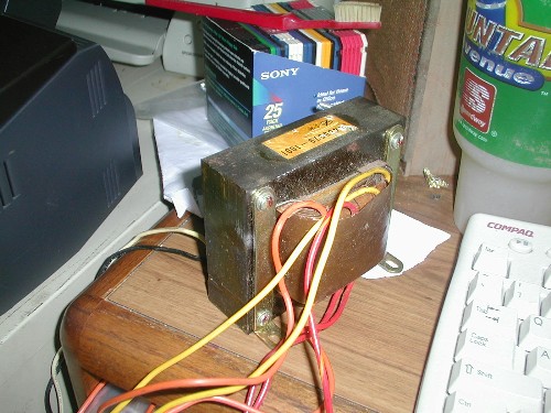

I also discovered that I have a huge power transformer lying around which will allow me to go with a 30V - 40V power supply. At first I thought it was for tubes because of the size and plethora of secondary taps (see attached pic). However, I put 12V ac across the primaries and all of the outputs measured between 1.5V and 4V (don't remember exact figures). I figure that I can make a mongo power supply out of it and use it for this project and add other pieces gradually to come up with a transitor multi amp system.
