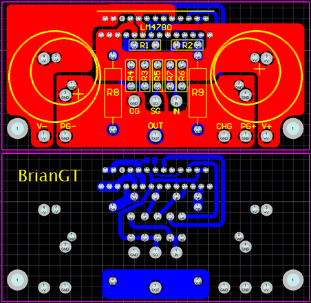

Here is a picture of the amplifier board layout. The power supply board will be similar to the last one from the LM3875 group order.

peranders said:Brian, I like what I see BUT the signal ground (red) trace should go more left and directly to the OG pad. Than you have got a perfect pcb!
BTW: Where are the decoupling caps? Can't see any.
Wouldn't connecting SG and OG pads with bottom layer trace trace take care of that?
There is no coupling caps, as they are not required here. All the amps I build now don't have coupling caps either. I used them before though.
Something that's crept in to later versions of this layout - the connection between pin 7, R1 and the output. I'm not happy about the noding here. The connection on the other half of the chip is a perfect textbook example of how to do it, but the "T"ing of the output connection worries me slightly. I can see the space constraints that have caused you to shape the track in the way you have, but could you not run a track on the red (top?) plane from pin 7 to R1, and then take the output from R1? The via shouldn't cause a problem here, as it will have the wire and solder from R1 to "beef up" the connection.
I also agree with peranders about the track linking the earth planes - it doesn't need to be so long, and would be better connected to the middle of the earth plane. I also think that the OG would be better if you moved it to be between OUT and SG - the symmetry would definitely improve performance - easily measured (if not necessarily audible). However, this is only an issue if you're not bridging a pair of boards, so I don't feel that strongly about it.
Have you considered moving R6 and R7 around to the right of the IC, behind the cap? It would reduce the length of the input traces, and these are at a higher impedance than the input node, so slightly more susceptible to pickup. You might even be able to make the board slightly smaller as a result. (Although, is the spacing of the caps chosen so that you can easily get to the screws holding the IC to the heatsink?). Also, the trace from R6 looks very close to the R9 output node, and as this is a non-inverting amplifier, the chances of positive feedback are very real.
Another small thing - the spacing of the resistors R3 to R7 looks to be non-uniform - is this the case in reality, or a screen-draw issue? Moving them all closer together so the spacing matches R6 and R7 will make it look a bit neater, and you will be able to tidy up the blue SG trace slightly (and the trace to R3, which looks as if it "misses" the centre of the pad).
Sorry if all of this seems unduly critical, but these are the sorts of details that I ask myself when I'm nearly ready to declare my designs "finished". I normally find that the critical analysis can take longer than the basic layout. But, I'm a perfectionist, which isn't always easy

I would be much more concerned with via than a T. There is no problem running this trace directly between pads, without the need for a T. I wouldn't recommend mixing 2 layers for that.
As to the output ground 200mill won't make a difference in performance, but it will make big difference in how easy it is to run the connection wire. I don't care for perfect symetry. I care much more for convenience.
The spacing it's done here on purpose. Those are not Krell (or Kristian's boards for that matter) where everything is lined up and spaced perfectly. Looks were not considered to be the goal, but performance. The board accomodates Caddocks, but I have strong feeling that Rikens will be better here, so this extra space allows to mount Rikens as well (in vertcal position). You wouldn't mind putting them this way? After all those extras on the leads are part of 3-D layout, (popularasied by Jonathan Carr)
Even if you place those resistors closer to the chip, you still have to run the connection wires around the board (this makes those wires longer) so I don't see much difference here. And anyway, there is no space to place those resistors there. Again having conveniently placed input access points on the board was major deciding point.
I would rather modify the traces (less square) and this would further reduced their length.
Regarding the "trace from R6 looks very close to the R9", look how close those are on IC pins
mhennessy said:Sorry if all of this seems unduly critical, but these are the sorts of details that I ask myself when I'm nearly ready to declare my designs "finished". I normally find that the critical analysis can take longer than the basic layout. But, I'm a perfectionist, which isn't always easy
It took at least 5 days and countless hand drawings to finalize that layout.
I'm still working on a DAC (for almost a month) before committing to final layout.
So be asured that a lot of thought went into those amp boards. Also, we ride on experience gained with a previous version, which tested by hundreds brought only positive feedback
