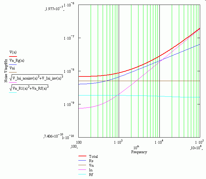

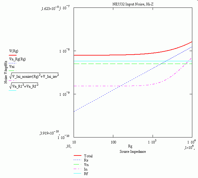

Konnichiwa,
I have a few comments that may or MAY NOT interest you. They are meant constructive, in the interest of improving the design further....
1) For a MM sensitivity Phonostage to be used with a MM Pickup the Op-Amp's current noise dominates the noise unless the Op-Amp is very noisy. This due to the very high inductance of MM Cartidges, up to around 1H which causes material levels of impedance to appear on the input.
With FET input Op-Amp's input current noise is virtually nil, MOST BJT Op-Amp's have a rather high input current noise which will make the stage noisy with MM Pickups. For MC picups (even medium/high output types) a BJT input Op-Amp tends to be apropriate as the source impedance is low and the input noise current matters much less.
Also, MM Cartidges require a correct capacitive load (usually quite high) which forms a resonance circuit with pickups inductance to boost the treble. Usually the best course of action is to shoot for a capacitive load that places the peak at 18-20KHz and to adjust the load resistor untill a pink noise spectrum in the middle of the record shows no HF lift or droop. Then there will usually only be a small amount of HF loss in the inner groves.
2) This is a trick I learned from Allen Wright and have used many times by now. return the AC coupled Feedback loop components (R3/C1 & R4/C2) not directly to the Op-Amp output but to the output after the output coupling cap C3, follow this by the "build out" resistor R6. By insluding the output coupling into the feedback loop it's sonic influence is lowered somewhat and LF RIAA accuracy improves. Sounds notably better wherever I tried.
3) The RIAA capacitors are chose quite high in value. Remember that output stage must supply the current to drive the RIAA network and any external capacitances too. The load at high frequencies from the current values is equal to 1k in series with 3n3, this is quite a notable load which may make many an Op-Amp distort more than neccesary, especially in terms of the various non-harmonic distrotions.
I found scaling the impedances in the NFB Network up by a factor 10 (meaning all resistors * 10 and all capacitors /10), all else being equal sounded better with all the common Op-Amp's I tried. Also smaller value capacitors can often be had in better quality. For fun, try a air dielectric AM Receiver variable tuning capacitor adjusted to 330pF in the HF section of the EQ (they often have two identical sections with excellent tracking making one good for stereo). Very earopening....
The noise is usally dominated by the source and Op-Amp together, so the increase in noise from the higher feedback impedances tends to be minimal.
Combining 2 & 3 can mae a surprisingly large sonic change, which I at least consider a bona fide improvement.
Lastly, if you can find a 4-pin connector for the powersupply consider keeping the "grounds" of both supply lines seperate and only connect them together at the "power star", which would be the point where the output current loop and PSU decoupling capacitor current loop are "starred". I would recommend also seperate ground lines from there to the Input ground with R2 returned to the respective channels input "ground" point.
Anyway, just a few notes.
Sayonara

Your suggestions here are all very reasonable ones. In the spirit of discussion I’d like to respond to a couple of points.
Impedance of MM cartridges and op-amp noise.
If, indeed, the inductance of the cartridge is in the order of 1 Henry, then your suggestion that a FET input op-amp would likely have lower noise than a BJT input is at higher frequencies generally true and I urge anyone with such a cartridge to consider the OPA2134 etc. over the NE5532 in this circuit.
With a FET input op-amp it might also prove useful to scale the feedback components by 10. With larger impedance it is easier for the op-amp to drive, and with the high source impedance + low current noise op-amp there is no noise advantage to keeping it low anyway.
Since scaling the loop still keeps all the parts as standard values, its easily done.
Not all cartridges have such high impedances however. My daily-use Grado 8MZ has a resistance of 470 ohms and inductance of 45 millihenries. The more expensive models of that series have a resistance of 70 ohms and inductance of only 8 mH. Over most of the audio band the source impedance is below 1k, and best noise performance is obtained with bipolars (low voltage noise) in combination with low values for R2. This configuration will however favor op-amps with low distortion drive into 1k ohm loads - the NE5534 being one of these.
C3 in the FB loop.
That’s also an easy mod and worth trying. The only curiosity I see with doing that is the feedback at DC falls to zero. I actually prefer the sound of those nonpolar 4.7uF Black Gates to a piece of wire (I find it adds a hint of warmth with no loss of transparency) so I'm personally quite comfortable with the conventional position. The low frequency response is 3dB at 4 Hz for 10k load, or -0.25dB at 20 Hz, so likewise the RIAA error it induces isn’t something I’m going to lose sleep over.

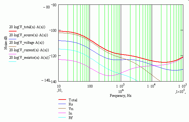

The 50kHz Neumann correction (I don't call it AW as AW, AFAIK, did not 'invent' it) gives a 0.5dB rise at 20kHz. Lower than the frequency response aberations in almost any MM, MC, or dare I say it, curring setup. This is not the cause of brightness.
In fact I have a prototype on the bench, including 50kHz correction, measuring almost ruler flat up to 20kHz, and yet I can turn it from lush into steely merely by swapping one capacitor type for another.
I would rather look into the compound response of the opamp + RIAA network, calculated/simulated with the ACTUAL measured R and C values.

Ran through some analysis for ya -
Rs is the source impedance (cartridge) contribution
Vn is the op-amps voltage noise, 5 nV/rtHz
In is the product of the current noise and input impedances
Rf is the resistor noise of the feedback arm (R2 and Rf combined)
The plot shows various contributions to the total noise, for a NN5532 / 1Khz. The resistors are as per a VSPS in the hiZ configuration: R2 2.2k, Rf nominal@1kHz (220k). That's a hypothetical worst case scenario, just to see if hanging big resistors off a NE5532 makes a significant difference. The answer is: no, not a big difference. Switching to a OPA2134 won't change the total noise all that much either.
Remember that input-referred noise performance is not exactly the be-all and end-all of a phono preamp design. I just thought a quick calculation might be informative, that's all.
-rjm

Re: noise
Konnichiwa,
Hmm, lets a Shure V15 (680mH/500R IIRC) with a 47k Parallel resistor.
The Impedance of this is around 910 Ohm @ 100Hz, 4k3 @ 1KHz and 22k5 @ 10KHz.
The Philips Datasheet lists the NE5532 as having an Ein of 5nV|/Hz at 1KHz and the Iin as 0.7pA|/Hz.
This current noise translates in a voltage noise derived from the impedance and the noise current as 0.6nV|/Hz @ 100Hz, 3nV|/Hz @ 1KHz and nearly 16nV|/Hz @ 10KHz. Or in other words, the noise from the source will be 10db higher at high frequencies than that from the source and in the "midrange" it will be more less the same as the self noise.
In other words, the self noise of the Phono Amp changes from "pink" to "white" with an emphasis on high frequencies and reduced S/N ratio. Given that the NE5532 is a little marginal for phono applications to start with, using a low noise FET type will eliminate the noise rise with frequency and keep the noise "pink" and low, with traditional MM Pickups.
For Grados NE5532 is not a bad choice, though other op-amp's are being made, with potentially superior sound.
Sayonara
Konnichiwa,
rjm said:Ran through some analysis for ya -
<heavy snipping>
Sayonara
Your numbers look right to me.
But .. you'll notice its the source noise 4kT Rs rather than the current noise term which dominates even for the NE5532 -at least below 10 kohm. So no benefit to further lowering the current noise by going with a FET input stage except for the 20kHz case.
(For those (trying to) follow - Rs is a function of just the input impedance and isn't influenced by the opamp at all. Current noise voltage is a product (loosely) of the source impedance and the opamp current noise.)
I'm not saying no benefit to a FET input - there is a benefit (the high frequency situation you mentioned) but it is more marginal than I originally thought - I had assumed current noise would dominate even at moderate frequencies and source impedances.)

Pick and op-amp, any op-amp!
For fun I reworked the sim to include the frequency dependence of an inductive source and a complex feedback impedance.
Now we have frequency on the X-axis, with noise calculated for a Shure V15VMR (1kOhm + 425 mH). VSPS circuit, NE5532, LoZ version shown.
1/f low frequency flicker noise is not modelled, so I haven't shown below 100 Hz. Opamp noise taken as the 1Khz datasheet values.
The blue line is the source noise. That's fixed by the cartridge and cartridge alone. The game is to try keep everything else below this as much as possible.
The horizontal brown trace is the opamp voltage noise. It starts to dominate at low frequencies.
The pink trace is the current noise. Somewhere above 12kHz, it overtakes source noise. (For the Grado cartridge it doesn't do this until above 100 KHz.) With a FET input opamp the current noise drops off the graph, no longer important.
The light blue trace is the noise of the feedback loop. It decreases at higher frequencies because of the RIAA filter. In the LoZ version shown, it doesn't play any significant part, but with the HiZ version its about 8 nV/Hz, about the same as the voltage noise of the OPA2134, and slightly higher than an NE5532 (5nV).
So it all confirms what we've been discussing:
FETs get you lower noise at high frequencies.
Bipolars get you better noise at low frequencies, unless the feedback impedence is high.
Somewhere in the middle it doesn't matter since source noise dominates.
And its all dependent on which cartridge you use.
-rjm

Same data as above, but referred to the output by multiplying through by the gain and displayed in dB.
The RIAA eq. means lower noise frequencies are amplified more than higher noise frequencies.
If anyone can suggest a better opamp to use for MM carts than the OPA2134 let us know! The AD825 has a good reputation, though you'll have to mess around with SOIC packages. It's noiser than the OPA2134 however...
Likewise a better op-amp than the NE5532 for Grado MI types.
