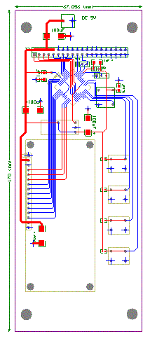

I think, till has answered all the question, I have modified the schematics, which will have to be reviewed then will come the tricky part and thats PCB layout, will be working on it on weekend as it will be a 3 days weekend, compared to noram which is 1 day back here in pakistan.
Once I m done I ll get back to the forum.
Till then keep ur fingers crossed.

Ok: guys as i did mention inmy last post this weekend i will find time to work on the layouts.
Till got ur email but right now don't have the attachments. let me forward the message again and c what u get this time.

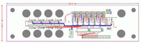

OK guys its good that regular and good quality inputs are keeping this thread running, as for me I had all the plans to make six channels PCb on the weekend, unfortunatly due to voltage fluctuation my 80 gigs harddrive got busted and along everything else it will take a while to transfer backup data to new harddrive nd make a new PCB, till that time be happy.
