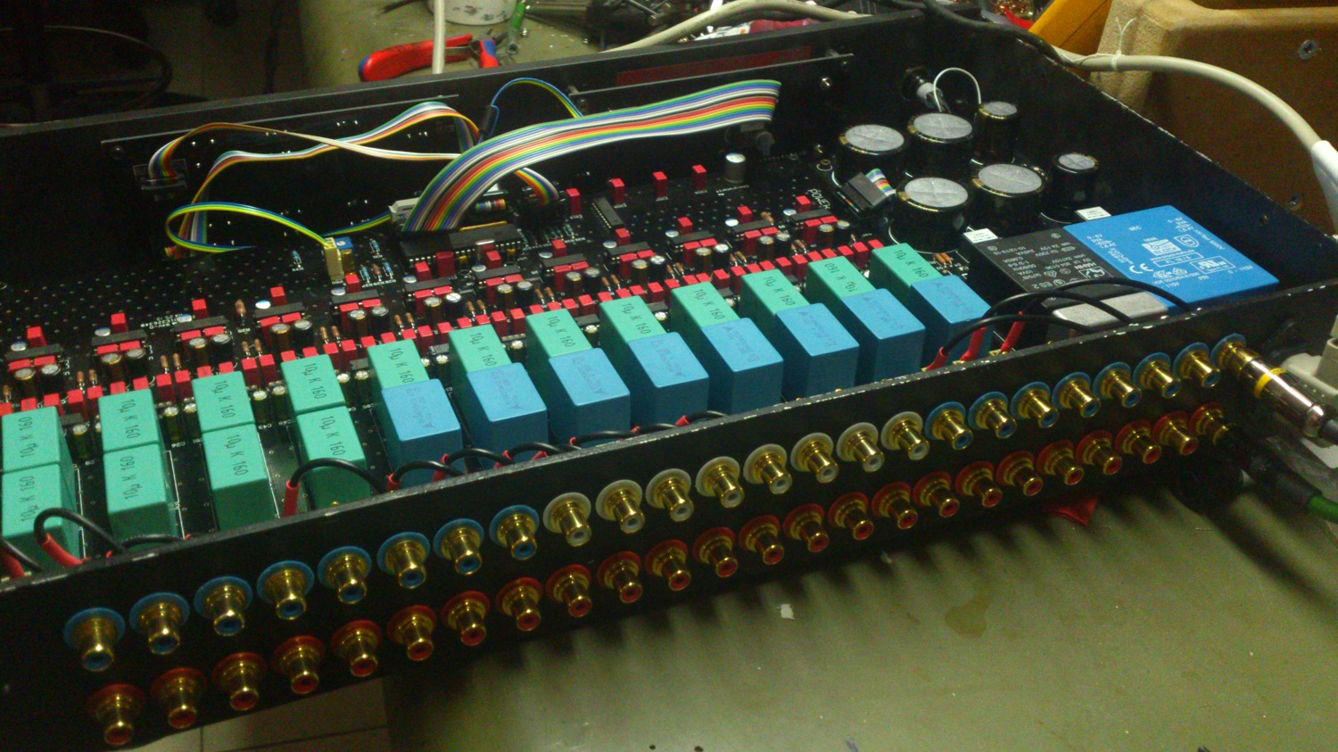

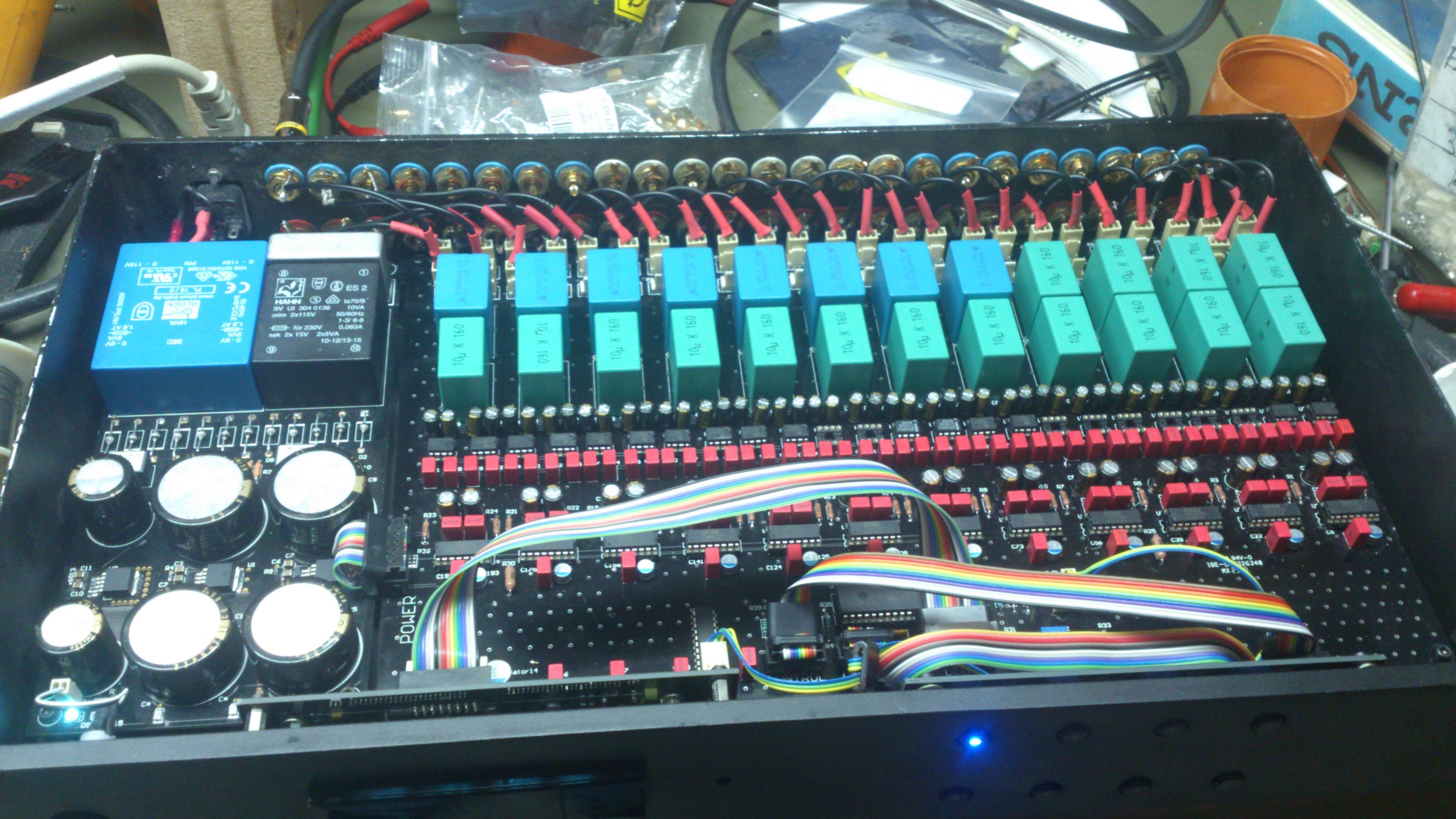

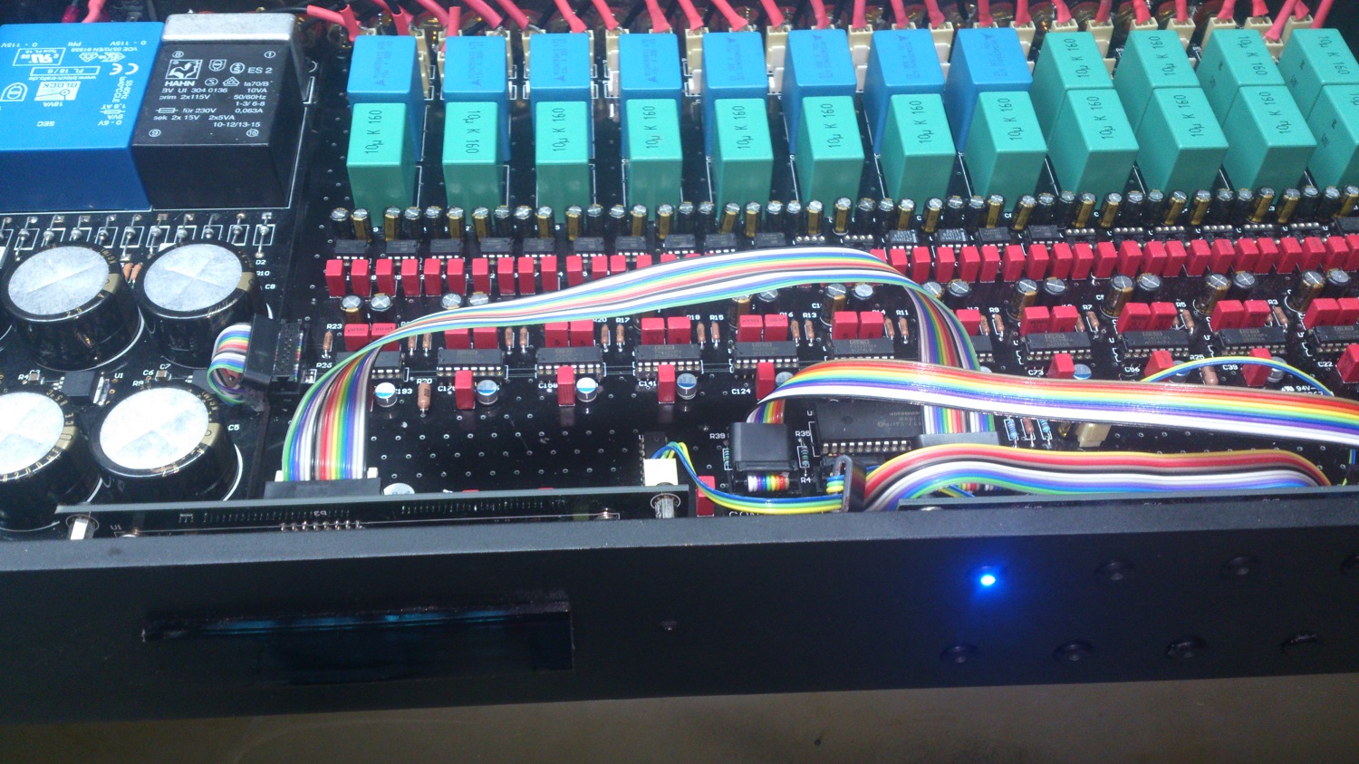

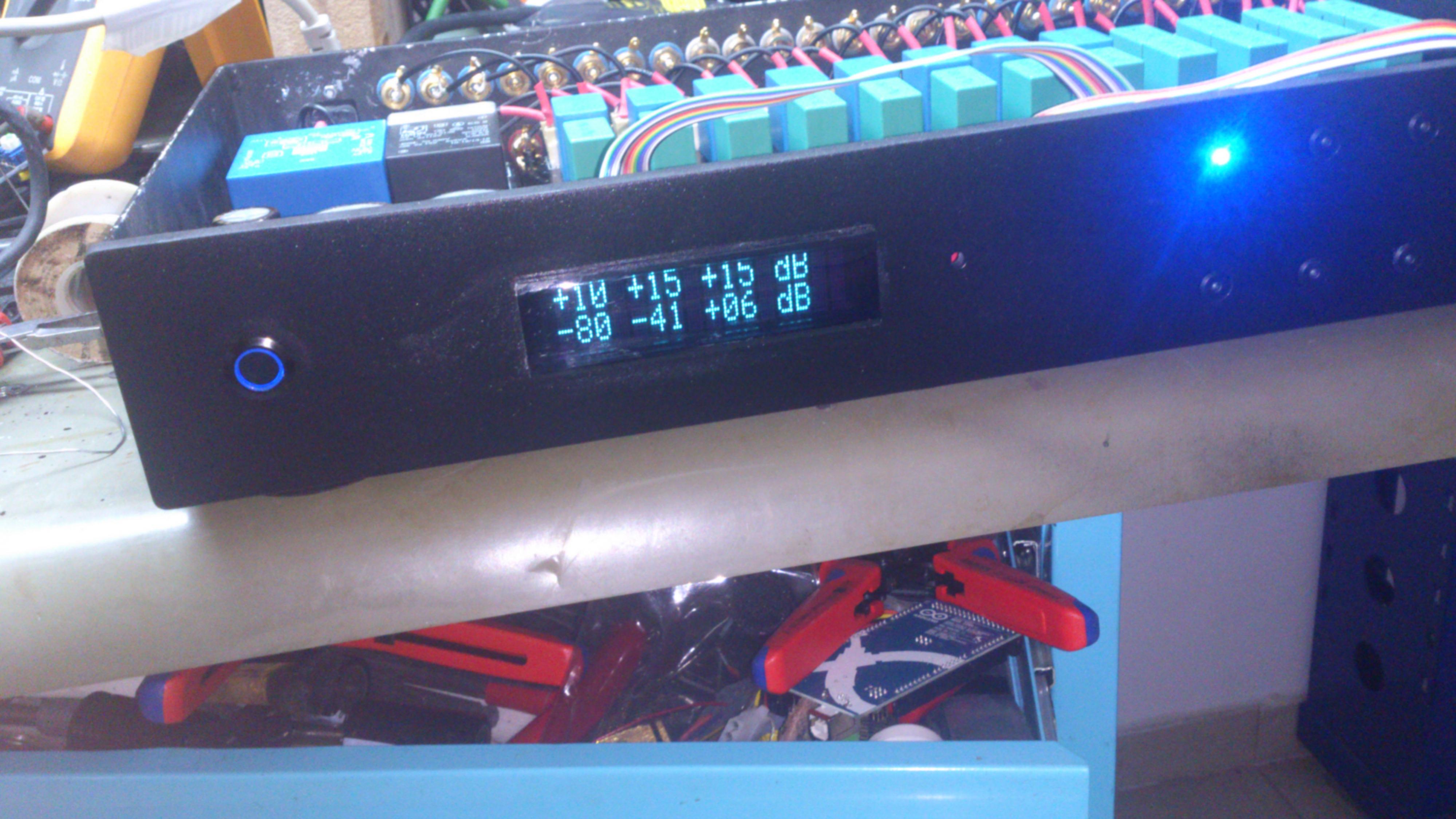

I'm using the PGA for a "digitally controlled" stereo preamp (still under construction, equipped also with an electronic crossover) using an ATMega16 as "CPU" and an optic encoder (2 bit Grey) as volume control.
With the integrated switch of the encoder I control also the balance by driving the 2 channels individually.
I'm not using a LCD display to show the "dB level" of the volume but 3 nixies and a ring of 16 LEDs around the volume control as volume scale.
Roberto
Roberto
