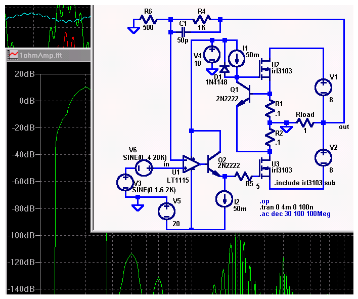

seems like fets and op amps could be made to work
i particularly like the "monoblock" idea, try floating high current supplies (use split bobbin EI xformer for low pri-sec C)
this is just a suggestion, needs some engineering to be a amp...
(D1 just helps spice find the bias point)
Bipolar transistors need a headroom voltage to operate correctly at high audio frequencies, generally 5V minimum across each half, so you are immediately thinking about Vp-p plus 10V at whatever quiescent current is necessary.
I think maybe confusion has happend between bjt's and fet's.
