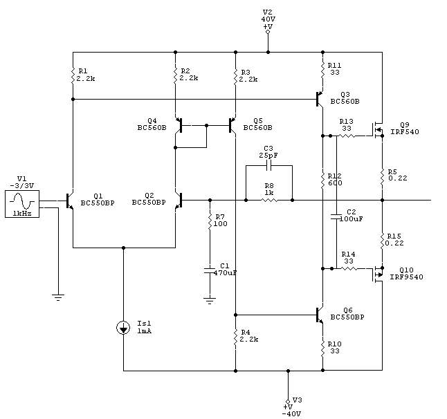

My entry............

Your entry is balanced and simple, but is likely to introduce a propagation delay which will affect the rising edges of transients, and impair high audio frequency damping. Though good I could 'imagine' it sounding less transparent than the very low propagation delay 'JLH class-A's do on complex passages, due to the way in which there is a potential to distort leading edge reproduction.
Is there an exponential start-up delay to the first couple of microseconds of say a 10kHz sinewave which varies with load impedance. Maybe fitting separate 220uF caps across each biasing pre-set will much improve both the transient and the NFB loudspeaker system damping responses by directly coupling the low impedance NFB divider to the input sources.

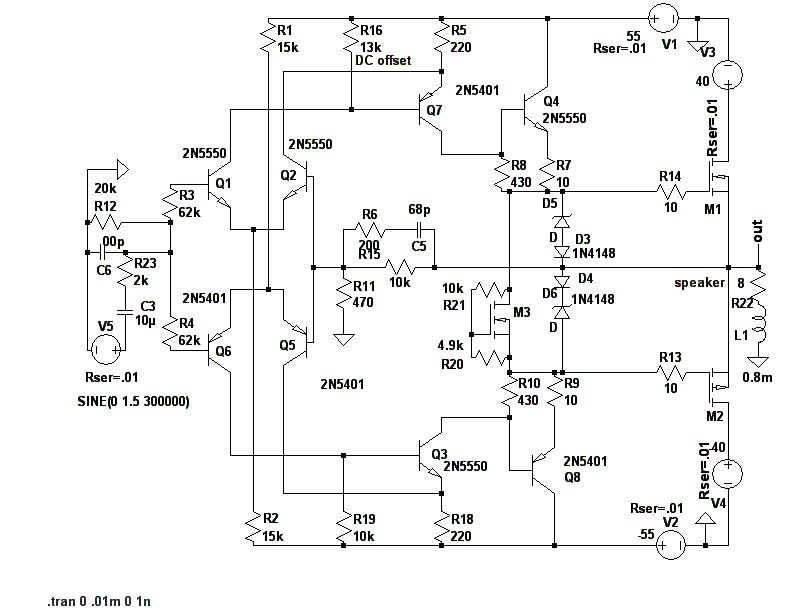

Hi Subwo1,
I have similar reservations about the input delay that might arise with your 62k series input resistors; I have not come across such high values before with a bipolar input. If they are included for reasons of high frequency stability, then they must equally degrade loudspeaker back emf control at higher audio frequencies because Q1 and Q6 do not provide a low impedance for Q2 and Q5 NFB reference.
I suspect that the C-bc currents of Q7 and Q3 will begin to have a delaying effect upon Q1 and Q6 responses in much the same way as when Miller C.dom capacitors are fitted to differential pairs that have emitter resistors.
Q1 - Q2 and Q6 - Q5 currents might be balanced at dc, but they could become phase shifted at higher audio frequencies, and especially on leading edges.
I note that your circuit is well balanced, and that the output devices are driven both into and out of conduction with low series gate resistance which is good for high frequencies.
I also wonder about L1 and R22, and whether it is intended to be the loudspeaker, or a series output choke network. Individual loudspeaker driver units might have series inductance, but when used in composite loudspeaker systems their rising impedance characteristic is normally compensated for by series capacitance and resistance; this approximates a resistor load.
Guys. I am not wanting to offend anyone here, or appear to be big headed. I haven't heard your designs nor simulated them. But I have heard and simulated amplifier circuits, and thus become aware of many short-comings as a result.

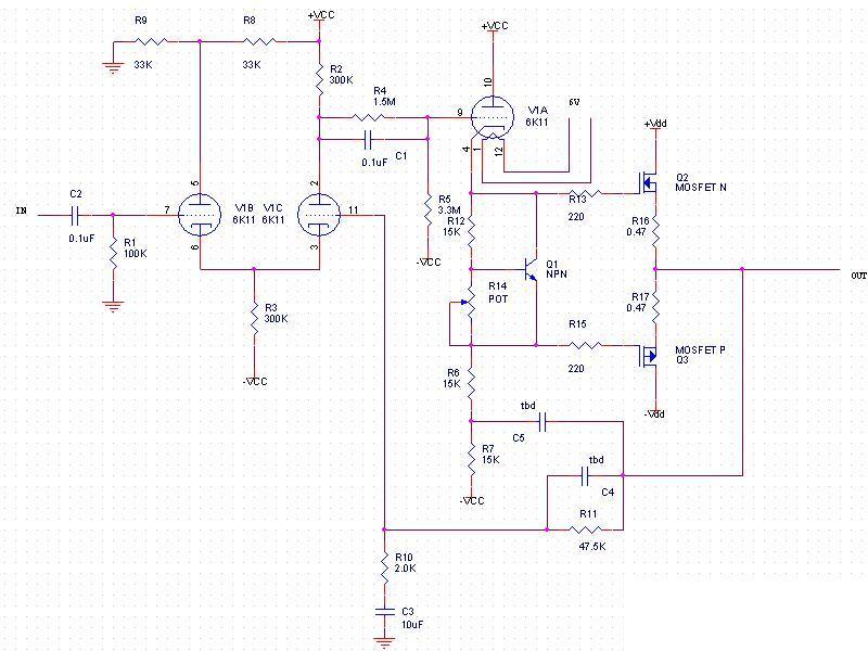

Well, this isn't exactly a totally solid state topology & the SOA, PS, dc offset adjust, paralleled output MOSFETs and startup circuitry have been omitted, but it's a representation of the HT dc coupled hybrid circuit I'm working on. Only one voltage gain stage in the amp, yet it should be capable of <1% distortion up to near clipping and possibly 100khz closed loop bandwidth with 26db of gain & only about 6db of AC loop feedback, so unconditional stability should be possible to achieve, even without an output choke. This is planned to be one of six channels for my HT amp project with each one good for 150WRMS into 8 ohms.

How about posting your circuit? This is after all an exchange of ideas and no offense is taken, and I hope it keeps that way.;)
Subwo1,
I noticed that your collector resistors for the diff, seem rather high, care to explain.

I am very glad you asked, jam. First I would to mention that I am presently working on improvements on my circuit and am anxious to post the update. Some of the changes are based on recent diyaudio member suggestions.
I continue to evaluate the comments Graham offered. The 62k input resistors do delay the input, but I think that since they are before the feedback loop, they don't add any real distortion to the signal. They do in fact enhance stability since they permit the feedback more opportunity to "catch up" to the input.
Presently, a preliminary explanation of those input transistor collector resistors (VAS base pull-down resistors) is that they work in concert with the 62k input resistors and the cascode effect of the feedback transistors' connection to the VAS emitter resistors. I agree that further explanation will be good and forthcoming from me or knowledgeable diyaudioers. I invite comments, even if the consensus ultimately indicates that my idea is quite flawed.
