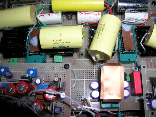

hi all,
perhaps not too many people know about the sanyo OS-con cap.
This cap is special in digital circuit.
low noise, low esr. with OFC lead out & silver plated.
This is another cap except Elna, & Blackgates that was good for digital use.
This is the best that I can follow with the standard kits.
pls see the photos.
thanks
thomas

I agree direct coupled, filterless. But when I testing. I like the choke load for 6c45 much more. CCS I don;t like it although much
linearity.
pls see the photos of the prototype.
I try the OPT already which use audio consulting silver wire amophorous core.
The two copper tape cover is the two TDA1541a.
thanks
thomas

Thanks for your compliment, this several days I was testing the BUV series compare for the MBR & Schottky series. If the price not had too much different, I also will considerate follow with the kits or options.
Best is direct coupled, filterless (but use Anti Sin(x)/(x) Filter), transformerless 7308 (Common Cathode stage per channel), biased directly from the -2mA offset of the DAC at a few 100mV, low anode voltage, choke or CCS load. Watch linearity though, this arrangement is a bit critical, the Valve operates near zero bias. But the short chain of: Chip -> Resistor -> Grid (cathode direct to ground) -> Cap from Anode to output works best from where I stand
linearity.
thanks
thomas
www.diyaudiocraft.com:smash:

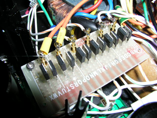

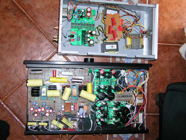

more photo of the prototype to test DAC.
thomas
thomas
