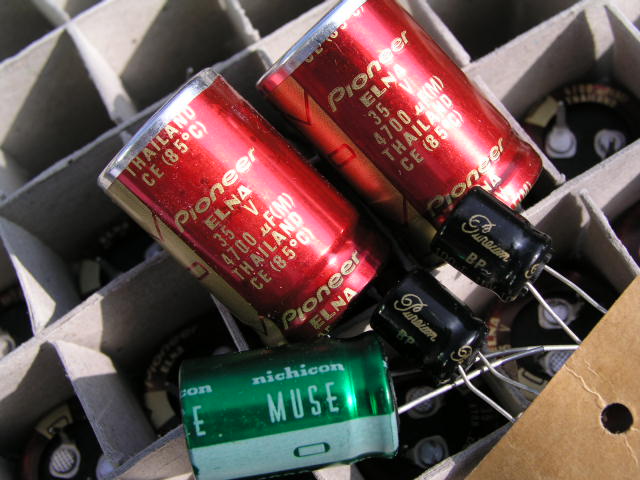

Parts I will use same grade as version I, but in tube PCB, pureism Bi-polar BP caps will use into the cathode cap of tubes.
Nichicon Muse & gold tune, Elna , OS-com will contain in the kit too.
Pls see photos of the new parts use in the version II kit.
thx
thomas

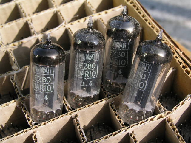

Another I forget to tell U is version II I will follow with one NOS MINIWATT EZ80 ( Brand new) for diyers. This tube working with very good performance in the tube buffer. Unless U use the telefunken,or Valvo made in Holland. Diyers not need to use the cheapest sovtek one to worse the sound quality.
This is one of the 2005 new year gift for them.
thx
thomas

For the cathode cap, have you done any comparison between Pureism and BG N? I have no way to find Pureism here. Part Connexion also has problem to fill up BG orders in a timely manner these days. Very frustrating!
Actually in my test, In 6C45 output stage use OS-con & balckgate will very thin & weak sound field sound although quite deatil. Like a cheap DVD player sound. Not said they sound bad, but not my cup of tea. Pureism BP cap not excellent. But higher density in mid freq & deatil. This will soft the rough of 6c45 sound. This is the same reason why I buy a lot of EZ80 from overseas for the new tube buffer. I hope to use NOS tube character to weak/ smooth 6c45 or other sovtek tube rough hear sound.
Special in the 6C45 output stage. use battery bias can clear the background. BP pureism can higher desity the mid-freq. Tea or coffee. which one U will choice.
The battery in the battery not need to change very frequency. the current running also 10~12ma in that place. but when operate will same time recharge almost 6~8 ma. So one AAA battery need half a year to recharge only. But very interest was different recharable battery had different performance. I think this was effect by different internal resistance.
