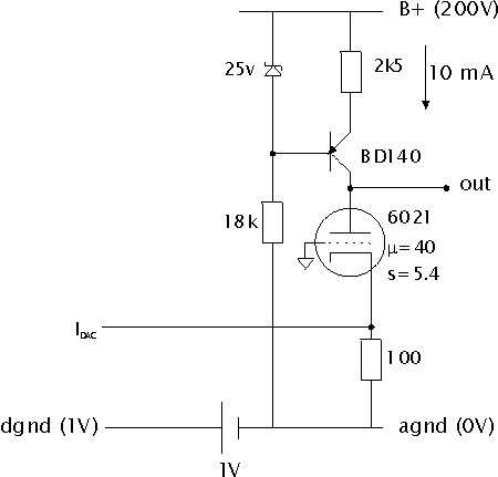

You are right, this is not a gain stage, but a tube-i/v-conversion. As described in the article you bring the impedance which the current output of the 1541 sees significantly down like with an opamp (which is an advantages over the resistor) - but you don't have an opamp in the signal path, but a tube which I would see as an advantage as well. Curcio audio uses the technique as well in their DACs and the feedback abut their DACs is very good in general.

parallel
Hi Blitz,
The circuit was used BD140 & run in CCS than pass to tube buffer. I agree this is a good method. Thisd is a common grid method. But U need to match the BD140. This circuit also use the resister to i/V. The 100Ohm is the i/V resister. But I don't like CCS. Why I not choose AD844 + 6DJ8 SRPP or AD844 + parallel 6dj8 two triode buffer. Looks will more simple.

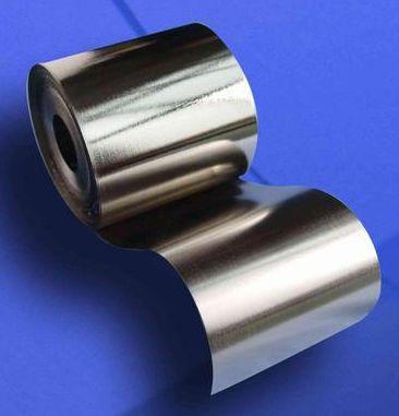

The ground area is quite large. But my friend ( He was the boss of one computor monther board, display card & power transformer company, he produce above item by himself in taiwan) This is his website.
http://www1.2themax.com/index.asp
And he said the signal path would electroplated a very thin layer of silver or gold. The signal will run more smooth, shorter path to prevent the error message.
I think Bricolo opinions is every signal path was cover by two ground plate to lower the noise. Is it right??

Hi Blitz,
This is my opinion.

P.S. I was testing use the amorphous paper on the top of the chips to lower the noise.
any comment??
I can get them in low price because I order amorphous c-core to wind the OPT from this Lab.
~National Amorphous and Nanocrystalline Alloy Engineering Research Center~
Their Engineer told me that for D/A CHIPS. Amorphous paper will be better.
If it really a good one. I will considerate options to the kits.
