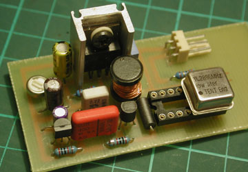

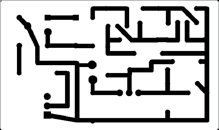

Here are the PCB board image of 317/431 power supply for XO. The images is ready for direct printout without the need of resizing. (The size of this board is 2.324 inches in length)
This board had not included the transformer, diode and first filter cap (470uf).
I made the supply and the result is good. And would share this to those interest.

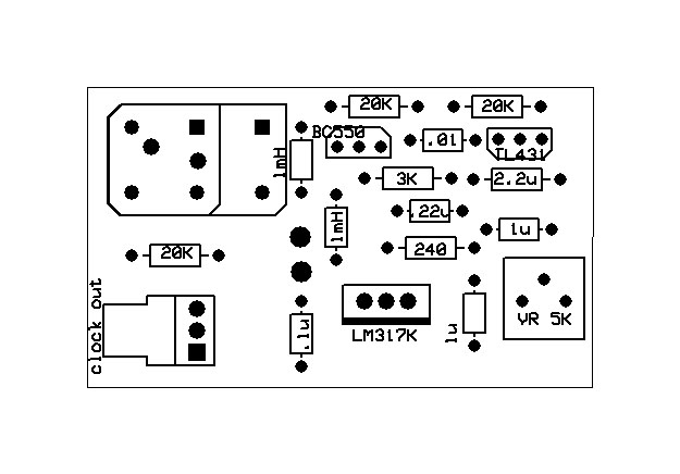

Another Error

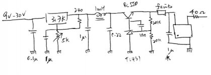

Hi LeoJar,

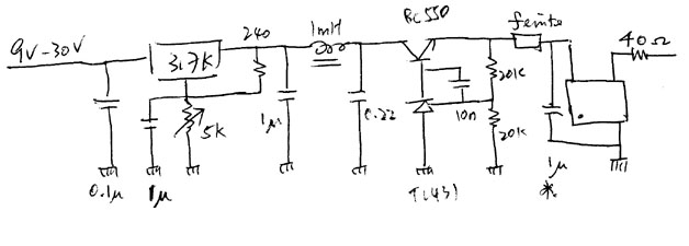

You missed the resistor between the collector and base of the transistor in the schematic. Something like 2k7 will do.
Seems like it is in the layout as 3k??. 😕
LeoJar said:Here is the schematics.
two errors in the layout. 1mH = ferrite; 20K =40 in clock output
Hi LeoJar,

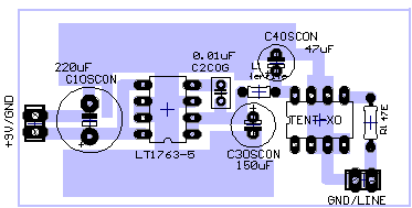

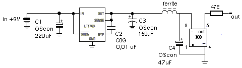

I made a board of it using his spec. and comments.
I have been using from then. But now I'm thinking on changing the design of this little board.
I attach the schematics and the board in order to get some comments from all of you.
Could you, please, say something about?

trafo for the supply
You can use it to supply an XO module using a pair of 9V bateries or an external transformer.
Actually I'm using one of the +8V connections inside my CD player.
But I thinking to built a board for a trafo to supply, something like the ones you can see in the second page of the thread mentioned above: http://www.diyaudio.com/forums/showthread.php?s=&threadid=16179&perpage=40&pagenumber=2
Guido's supply use a choke and some more filtering that the one from LCaudio (which seems to use an small ferrite, the one at one side of the V in).
Can any of you give me some advice on what kind of choke should be better to use, where to set it and which values could I use?

It's also good...
The noise from LT1763-5 is pretty low. I don't think there is any issue in using this chip..
I do try to build one and measure the noise level....
Leo

Re: the board
Hola Pedro !
Why did you place the decoupling capacitor so far away from the XO ?
I'd suggest to place it closely besides pin 4, at the right

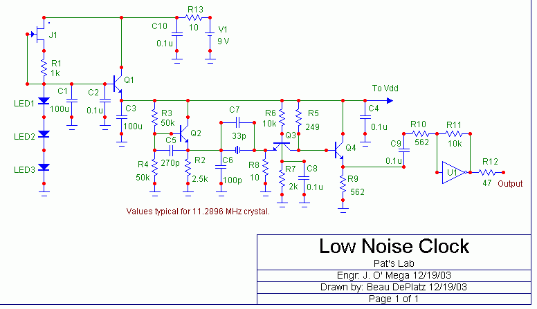

Wouldn't this scheme be more quiet?
Taken from Pat's Lab.
http://home.att.net/~patslab/3fe5755e.gif😉

Re: Clocxk power supply
LEDS are too noisy, the emitter follower will just transfer the noise
enjoy the weekend
Elso Kwak said:Hi,
enjoy the weekend
Who knows, unless you measure it!
I think there is more to it than noise spec. KK Hos power supply is not as quiet as Guido's but to my ears sounds very good.
It is also small and very easy to mount!
