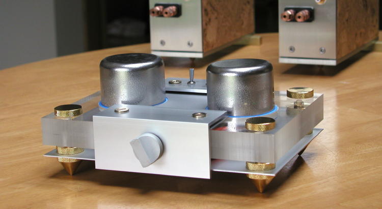

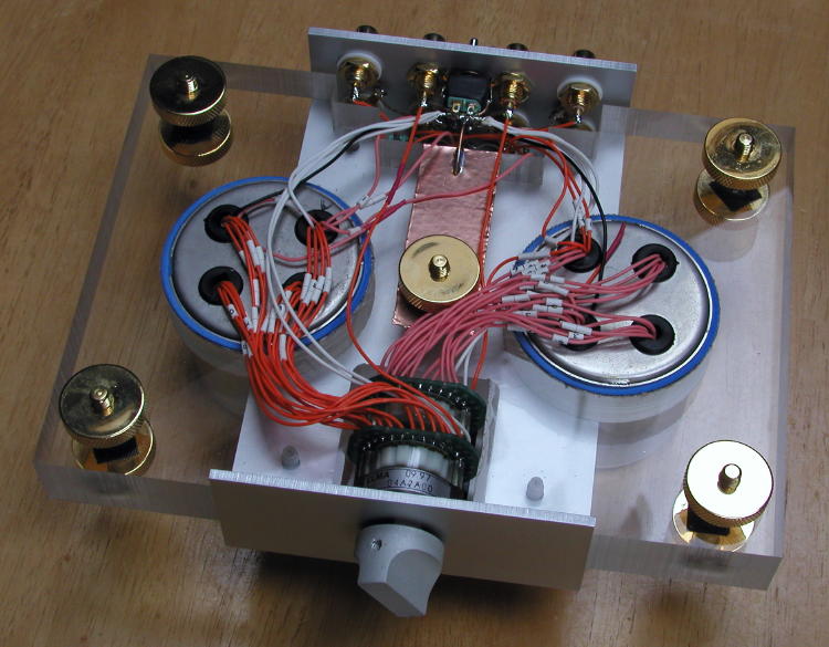

As usually I used minimalistic approach. The footprint is 8,5 x 6". It seemed natural to mount the transformers on the outside and 1" acrylic plate was used for that purpose. Since finding forster bits or saws in 2 3/6 size was hard, I cut out the opening in 2 1/2 size and used neoprene gaskets to stabilise TX in the holes. This provides extra decoupling as well.
To make everything more interesting, I used aluminum plate between TX and two angles for front and rear panels. Spacing them away from acrylic base, provides more 3-dimentional look. Special bushings were used to mount those angles.

Peter ... do you dream up the mechanical design while you sleep? Needless to say, it looks wonderful!
I think it comes with practice and training. The more I do this stuff, the better it comes out. Of course the current version has still some rough edges, but I'm also quite pleased with overall concept. It took me one whole Sunday to figure it out and build.😉

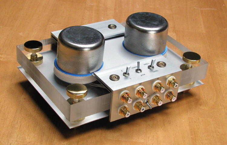

Of course it does. All the same i shall shamelessly copy it. Btw what are the toggle switches?
The switches are from ALCO. I had them in my bin for years and they seem to be good looking, gold plated. Also using toggles here instead of relays or rotary switches seems also to be more purist approach.
I already see some mistakes. First of all, I did a ground lift switch, but it seems that this feature is only good with balanced setup 😉.
Secondly, I would make source switching with separate toggles (left and right), so to avoid crosstalk and be able to switch both signal and grounds. I think I will redo it. Since the setup is so good I might also use Kimber RCA's.😉
I think phase switching is possible with that setup?

Peter Daniel said:I think phase switching is possible with that setup?
Yep, but even better is the way Allen Wright does it as part of the source selector switch in his preamps. Check his website for the RTP schematics.

By the way, most excellent work! You really have a knack for taking basic materials (flats, angles, etc.) and putting them together so the result looks anything but basic.

Design-wise it's something in between the Shanling tubeSACD, a CHORD and an Hovland.

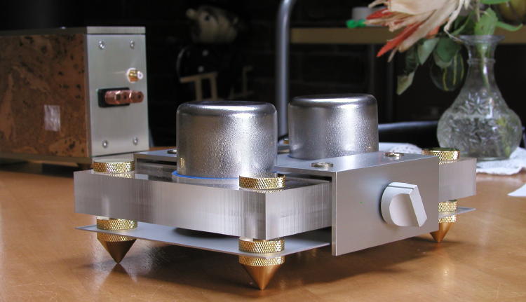

What is the blue gasket between the trafos and the chassis?
Does your wife have anything to say about you putting spikey things on her good table? 😉
