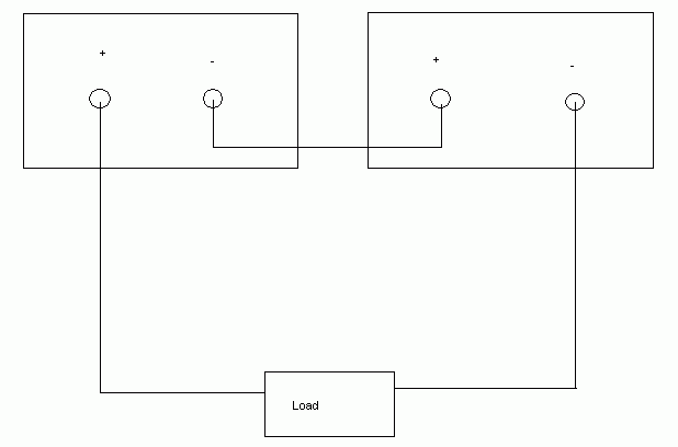

How do you bridge two already 'bridged amplifiers'? I never seen this before.
Can someone draw a schematic or block diagram on
how this works?

What you actually want to do is run the 2 bridged amps in series. It takes a very special set of circumstances to allow you to do it but it can be done. Pass Labs X1000 is a perfect example.

Series connection of two bridge amps seems perfectly possible to me. Say that one has two (car or others) amps which both have (switching) supplies where the output of the PSU is isolated from the (12 VDC) common ground which they usually are as the PS uses a transformer, AFAIK, so that the supplies for the two amps have no galvanic connection. At the same time assume that they use input transformers (or coupling caps on input AND ground if that should work well) to achieve lift/isolation from the input ground (possibly in order to remove possible ground loop/hum problems common in cars). Each amp is bridged and the respective output voltages have no reference to each other. Now connect two of those amps in series and you have two bridged amps in series. Should work but possibly not that well.
As always I could easily be completely wrong but it seems fairly simple and straightforward to me. No need for anything special or unusual.

UrSv said:
Series connection of two bridge amps seems perfectly possible to me. l]
Urban, the concept of series connection is that everything is connected in a long chain. If you have a bridge amp with a connected load how (where) can you put in the another amp?
I think (convinced) that it's impossible.....stop I think I have an :idea:
Like this as per the Pass Labs X1000.
Whay happens if I have transformer connected inputs and the both amps have isolated PS?
Still, less than 3 dB and does it produce high fidelity?
I must be hopelessly unclear today as that is EXACTLY what I tried to describe when I mentioned transformers on the input and isolated PSUs which you repeated again. AudioFreak provided the schematic for it and the only question is what phase he's feeding the setup and depending on that he might have to connect plus to minus or minus to minus.
AudioFreak:
The question was not how to do it technically, as that is quite simple, but rather I was suprised that it could be done with the X1000 as I thought they would not be isolated from eachother thinking they would be sharing a ground connection but then that seems not to be the case. If it was to provide the pic then thanks. Otherwise thanks again...
