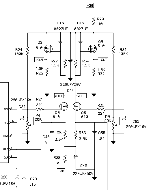

Has anyone tried modifying the D1 I/V stage? I am wondering if it would sonically benefit if it was converted to an X type setup.
Also, what about using current sources?
Here is a picture of the stage from the service manual:
( http://www.passlabs.com/pdf/d1-srv-man.pdf )
Brian

Single DAC use
Is it possible to use this I/V converter with just one DAC instead of two? For example by grounding the input of Q6. Will it work?
Brian,
You could get rid of R25 and R32 and replace them with 20ml current sources. With Mr.Pass's permission.

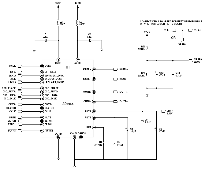

The datasheet for the AD1955 says:
"8.64 mA p-p Differential Output"
Do I need to change anything in the I/V stage to account for this difference, compared to the PCM63?
Brian
Brian
Check the DC output requirements of the chip, but otherwise,
ther answer is (should be) no problem.
In reference to the above schematic, I should point out that
the followers are not necessary for many applications, and you
could get by with the simple diff pair and the 1.5K resistors
(capacitively coupled, of course).

It seems that current output DACs are designed to
ideally operate into virtual grounds.
As the transconductance of the JFET in question goes
down, more signal voltage will appear at the source,
and any dependence of signal quality vs output voltage
of the DAC will start showing up.
That said, I would expect it to work fine.
