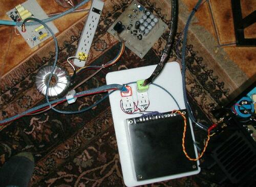

A stable low distortion oscillator is not that hard to build. I have built this type of power regeneration and it sounded great for powering line level devices (preamp ect) application. You can use a similar power transformer for the step up as you would use in a power amp. I have also used the output transformer from a very good 200 watt tube amp. I thought the results were well worth the effort. The distortion for my oscillator was over 80 dB down and the amplitude was much more stable than my AC line voltage at the wall. Ignore the horror story and give it a try. I would use the transformer or you have to build a very high voltage balanced amp. You also get the galvanic isolation that many use isolation transformers for.

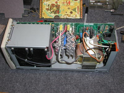

Here's UPS, I bought for $30. I'm using it as it is for line sources and it still improves the sonics (there is a difference if I run it from AC line or batteries, but usually AC is preferrable). It could probably be quite easy to convert it into true power regenerator, as the oscillator is there, so the amp and step up transformer.

The fews UPS I have played with sounded pretty bad. I think it might be a total waste of time to modify one. The money would really be better be spent on a decent power transformer and a DIY amp and oscillator. This is really a pretty simple project I have seen plently of one op amp oscillator circuits around that you can probably build with Radio Shack parts. Do not use a funstion generator IC they have an incredible amount of distortion. it is not that hard to build an analog circuit to very the shape of the waveform to lengthen the diode conduction time either. I guess it is time for some people to do some actual R and D.........

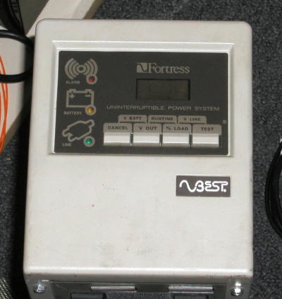

Actually my UPS is a Best and when I looked inside it's indeed some serious stuff. That's why I didn't want to touch anything, it just seems too complicated.
I wouldn't be using it, if it didn't improve the sound. Works very good with my DAC, I didn't notice much improvement with a transport and I didn't like it with Zen or GC amps.

You may be absolutely right that your ups improves the sound, but admit it: it's a dead end.
For anyone willing to experiment, a good start is a Wien-bridge oscillator as found in Art of Electronics or any other basic electronics text. Choose the circuit with a miniature lamp as amplitude stabilising element - it's usually better than the ones with fets. Use a decent opamp (5534 is perfect) and when setting the output amplitude check the distortion with one of the many freely-downloadable spectrum analysers and your computer sound card. The only real problem the Wien bridge has is the difficulty of varying the frequency - that's what prompted me to choose the AVR.
