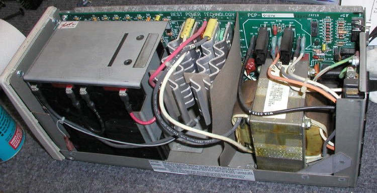

Best deal Ive seen on a Best.
Peter,
Didn’t you say that you paid jus $30 CDN for that supply!
My gosh that’s a great deal. I haven’t yet been able to find the Fortress spec sheets, but that is a great little supply. Off hand id guess that the Sine output is in the 1% or less range, not too shabby at all. Having talked to engineers at Best a few times, I think one of the things that set this company apart from the commodity grade fire starter UPS products, is that these guys really care about building a good product that does what the customer thinks it does.
A lot of the best product line (I dont think its just the FerrUps) use ferro-resonant boost buck transformers on the input. Its a great way of providing some line regulation and isolation at the same time.
Ive often pondered more about taking an old UPS and modding it to be an amplitude follower for a Sub woofer. I figure its not likely that I could hope to get 20 KHz response out of something designed to oscillate at 60 Hz.
Are there any more where that more came from? Its a great deal, even if it needs new cells.

That's the interior of my little UPS. It is rated 600W.

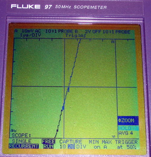

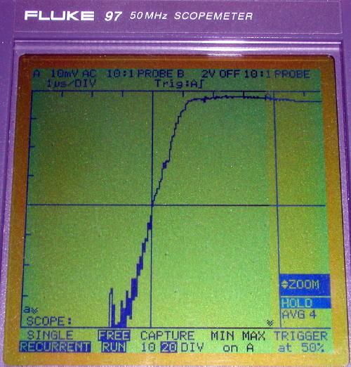

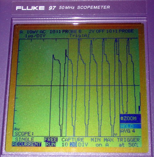

The measurements come in line with what I've heard. I prefer the AC power from UPS (comparing to raw AC supply) and I also preferred when UPS was run from AC and not from the battery.
Care to comment, Fred?

What I noticed today measuring the signal is that a AC supply directly from a wall improved the moment I connected the UPS to wall outlet. But the improvement wasn't as big as the one from UPS.

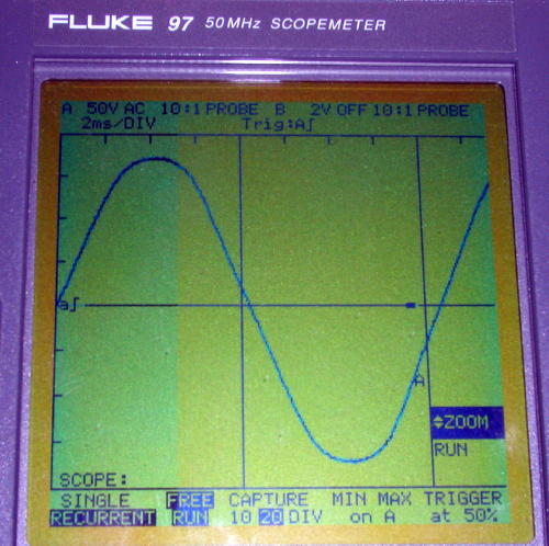

Peter Daniel said:That's better view of AC power from the UPS:
Peter,
If that's the clean voltage it doesn't look like a real sine wave, it looks like it has some major amount of odd harmonics to it.
Maybe it something inherent to inverters?
