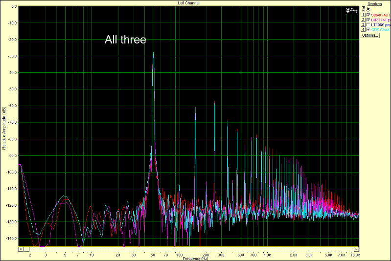

I have a simple question concerning the first post of that thread and "power regeneration" in general:
What is the purpose of generating a sine wave with very low THD and using it to power our audio equipment, when such equipment is just always going to rectify it?
PD: To see the voltage and current waveforms associated with the classic audio PSU that just rectifies a 50Hz or 60Hz waveform coming from a transformer, review this thread: http://www.diyaudio.com/forums/showthread.php?s=&threadid=66542
Note how the voltage waveform is clipped very hard and distorted by the rectification process, particularly with high loads, and note how narrow are the current pulses, thus containing a whole lot of undesirable midrange and trebble frequencies, even when the mains waveform is a pure sine wave.
So, Is there any point in keeping mains THD low?
