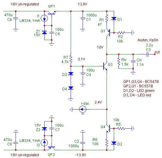

Finally finshed some boards and put them in.
The I/V is similar to the one here:
http://www.diyaudio.com/forums/showthread.php?s=&threadid=9226&highlight=simple+TDA1541
TDA1543 is still powered by 8V, bias pot has been removed from pin 7. Will try later with 6.1V and 5V.
NOTE: R6 is multiturn pot to set the Vc(Q3) DC level, I choose 10V
As I hoped, dynamics improved a lot compared to passive I/V.
It's got firm tight bass and sounds very transparent.
Compared to the TDA1541A-S1 with similar I/V this comes really close. The TDA1541A-S1 has more micro-detail, more texture to voices and instruments, but the TDA1543 sounds (surprisingly) more transparent and bass control is a bit tighter.
In fact my girlfriend prefers the TDA1543 now, thinks it's less irritating than the TDA1541A-S1 when the volume is up.
Application: Philips CD player, non-oversampling, Kwak-Clock similar to version 6/7, synchronous BCK reclocking with VHC logic, output caps are Audyn KpSn (Tin-Foil)
If somebody tries he/she could experiment to find the (soundwise) optimal voltage for the DAC's output, by changing the base voltage on Q3.

Simple Active IV for TDA1543
Hi Rudolf,
This is certainly something I am going to try too!
The difference in current supplied by the current source Q1 and the current sink Q4, is to compensate for the static current from the DAC?
What did you connect to Vref ?
I would also try a second common base connected transistor for Q3. (Fig. 12-9 page 235 in Low-Noise Electronic Design by Motchenbacher and Fischer.) "The CB-CB pair is useful as a wideband current amplifier."

The Current source supplies the total of the current sink, DAC bias current and DC current through Riv to get some Vce(Q3).
I think pot R6 is like 60~80 ohms or so.
I must admit, the Vce(Q3) is a bit low. But the results are still very good.
I left Vref unconnected.
One might experiment connecting a capacitor to it to find out if there are audible differences.
My next I/V version will indeed have a cascode. I carefully noticed Jocko's hints. It will be a folded cascode with another current sink that's cascoded by a J111 fet. This one shall be DC coupled !
Then I will start using some better BJT's like 2SA1085E & 2SC2547E

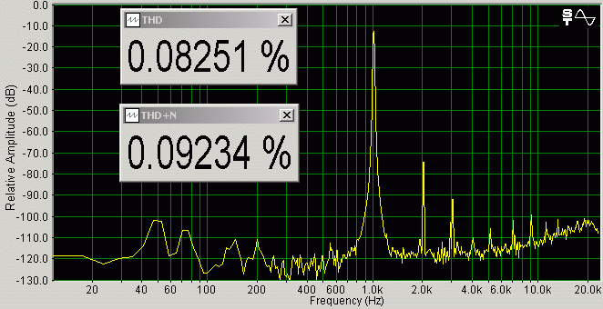

The distortion of a 0dB 1kHz sinewave, stays below 60dB for d2 and d3 when a proper DC adjustment is done. I have used 1350 Ohm for the Rref and 2k2 for the Rload. The VCC is 8,5 Volt. This delivered the best results, with trimming with help of a FFT analyzer, as well listening tests. But do not worry too much, as long as the DC component of the Output is between 3,7 and 4,1 Volt (with a VCC between 7,5 and 8,5Volt) the results are relatively similar. Outside this bandwidth the d2 and d3 increase very rapidly with a factor 10-30!! Very easy to hear as well, as human voices loose the smooth clean character. This will happen already below 3.5 Volt DC and above 4,4 Volt. When the VCC drops below 7.5, bass becomes thin and dynamics are less.

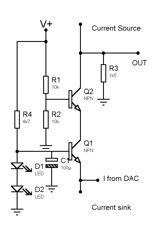

CB-CB Pair
Hi Rudolf,
Here it is. I omitted to draw the voltage regulators and the current source and sink only designated with text. A cap could also be added at the base of Q2 with is simply set to half the supply voltage with a voltage divider.

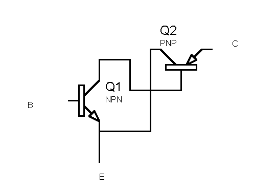

Jan I wondered why you did not bring up the Sziklai connection as published by you in The Audio Amateur 2, 1989?

Hi, The 2.23V voltage I measured is with a 3k3 resistor from Vref pin to ground as in Philips players using this chip.

Further thoughts on "active IV"
Hi Rudolf,
On further thought it might be an idea to combine the Sziklai and the second CB transistor, using three transistors in total. Also a LH0003 style or Walt Jung outputbuffer might be added and the second transistor folded. Or cascode the current sources.....And make the whole circuit complementary to avoid offset....
Actually I believe the IV-conversion is still passive using the current flowing through the resistor...😎
But I don't know how the similation sounds!🙄

Doede, can you post your distortion measurements? Scott Nixon once claimed 20% distortion with the configuration you mentioned, 60dB looks far better, sounds a bit too good to be true... I attached the measurement done using 6V supply and 1k I/V resistors (chip is plain vanilla, i.e. not crowned TDA1543 😉 ).
Rudolf, sorry for hijacking the thread… hmm, can you make some measurements?
Pedja
Pedja
Hi Pedja,Pedja said:Elso, this is something like that what Pierre-Frédéric Caillaud (peufeu) made about year ago using J309. He said he will publish his own work… still nothing… but I had once information from him, he said this folded cascade do sounds better. Pierre, are you lurking? (And I agree with you, all this still can be called a passive conversion, though the DAC’s out is buffered.)
Doede, can you post your distortion measurements? Scott Nixon once claimed 20% distortion with the configuration you mentioned, 60dB looks far better, sounds a bit too good to be true... These measurements are done using 6V supply and 1k I/V resistors (chip is plain vanilla, i.e. not crowned TDA1543 😉 ).
Pedja
Sorry I do not follow reasoning. By "this" you mean the Sziklai connection?. Cascoding current sources I did long before Peu Feus posting on AA. You mean folded cascode??
In fact a CB-CB pair isn' t a cascode; that would be a CE-CB pair.
