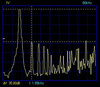

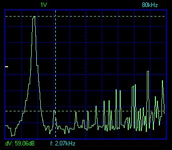

Correct, actually there can be found an optimum for any combination the 3 main parameters of the 1543 DAC:
1. The Rref
2. the Rload
3. The VB
In the 1st picture the combination was 1k38 2k2 and 8,00 Volt
Easy to check with a FFT anlyzer (real one or S/W and your soundcard in the PC) and a test CD which contains a 1kHz 0dB sine wave...... in stead of a fix resitor I used a 25 turn trimmer, just turning till you see the d2 and d3 disapearing almost !! no magic, no rocket sience
These values were both achieved by measurements as well later with listening tests, which were done blind. I used trimmers for Rref and the VB and found the best position (well best, I prefered this position) I checked the values later on and came up with 1350 Ohm ( !! ) and 8,5 Volt for VB
Just try yourself !!!

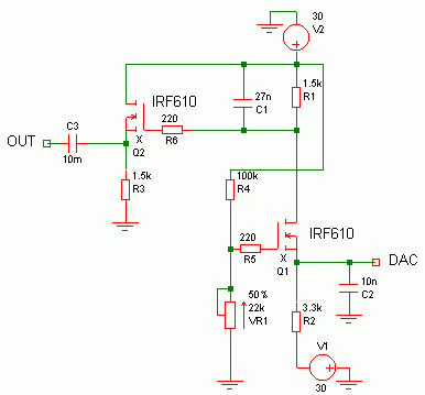

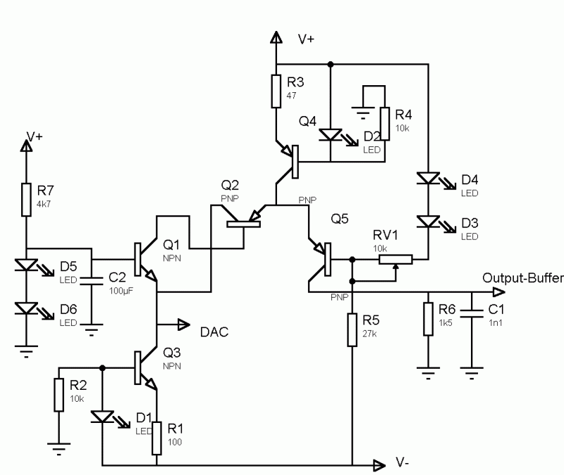

Hallo!
The schematic below derives directly from the Passlabs D1
I build it balanced and implemented successfully into a sony CD player . In that case the Dacs were looking for a virtual ground.
Now , I'm waiting for parts (TDA 1543, receiver etc) and I have not try it or simulate it .
I wonder if it will work with TDA 1543.
Hallo!
rbroer said:Stefanobilliani,
Sure it can work, just change the resistors so, that the gate voltage on Q1 is 2~3V higher compared to the one with virtual ground. This will lift-up the source voltage on Q1, hence the DAC output voltage.
Thanks for the reply rbroer,
what about a constant current source (better PSRR), and at what current? After searchin' around in the thread and projects seems that the preferred current for the TDA1543 is around 7-8 mA for I/V ; can anyone confirm this?
