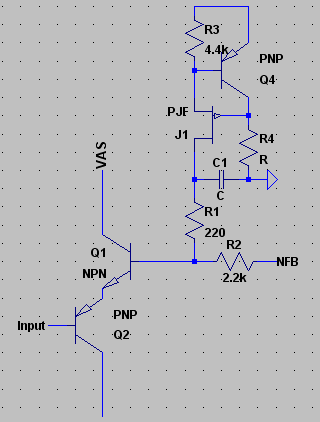

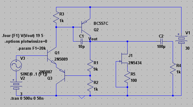

CFP gain stage, modifications.
Hello all.
As many of you are probably aware, I like screwing with the Rush Cascode.
Doug Self mentions the CFP gain stage on his site, but states that it has troubles reaching a gain of higher than 3 and it is difficult to adapt it to higher output power.
I've solved at least on of these problems.
By merging it with the Rush Cascode, I can run it at a gain of 10 at reasonably low distortion into a 1k load.
Implications:
1: I recommend using at least 1-2V bias voltage across the B-C junction of Q3. This bias voltage will be wandering by the same amount as the input voltage, which you may have to adjust for.
2: In order to keep a healthy B-C bias on Q3, you will have to have a supply voltage that is at least the bias voltage multiplied by your gain, plus the Vbe of your output device.
3:To get the low distortion, there has to be a high bias current through the output device.
4: C1 is necessary for stability.
Pros:
1: Higher possible gain.
2: Lower distortion.
Cons:
1: Will require higher voltage supplies for higher gain without making the circuit more complex.
2: Requires decent bias current through the output device to achieve low distortion.
Despite the disadvantages, it still performs better than the CFP gain stage at lower gains where you can use a lower supply voltage. The CFP gain stage is mentioned by Doug Self here:
http://www.dself.dsl.pipex.com/ampins/discrete/twoq.htm
I don't know if this is useful, but maybe it will at least interest you. Personally, my interest in the circuit is in the application found for the Rush Cascode.
Another thing I find interesting is the direct correlation between OP bias current and distortion. It is a perfect example of Class A I guess.
The circuit can probably be modified to phase out the mentioned shortcomings, but I haven't done much simulation in this direction.
So I would say that my biggest question is whether or not this circuit is adequate to be used commercially IE whether or not it is comparable to the other circuits available.
The circuit presented has a gain of 10 and a distortion of .0002% at the present signal levels. Output is 1V pk-pk.
The Jfet current source can be replaced with a resistor with and you will still have reasonable performance.
And yes, I know that I'm abusing that BC557...
- keantoken

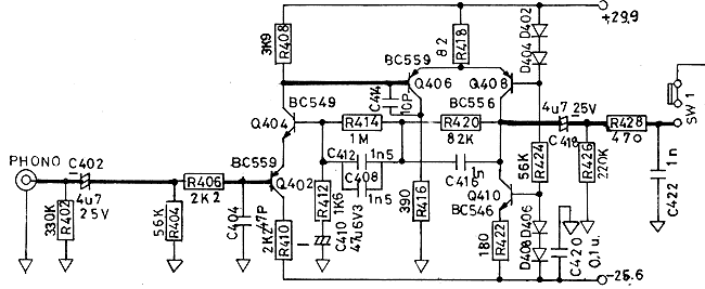

AKSA said:
Kean,
Take a look at the master, the NAD3020 phono stage from Tomlinson Holman, of THX fame. This was done on commission as he was completing his PhD about thirty years ago!!
Hugh

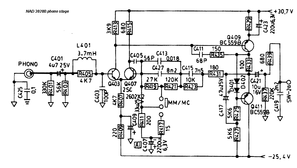

Hello Hugh
The first NAD3020 amp, phono stage, was considered as one of the best phono stage on the market and some guys was using it with high-end power amps.
Thank for posting it, I did have only the NAD3020B conventional phono stage version schematic only, maby I should do that Tomlinson Holman version as phono preamp, maby it could be better than using a OPA637 op amp for a phono preamp.
But the NAD3020B amp was no more using this phono stage and did use a more conventional version phono stage, I include the NAD3020B phono stage schematic.
Thank
Bye
Gaetan

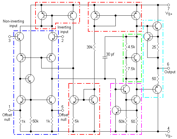

I'm sure everyone is already familiar with this, but attached is a schematic of the ancient 741, showing how it deals with it - DC offset cancelled by using two pairs, and floating bias.

Done a quick simulation of two unity gain followers
- CFP loaded by a 6 mA CCS
- Rush pair input + EC load by a 6 mA CCS, 100% NFB
bipolars 2N2222 and 2N2905
+/- 20 V power supply
both loaded by a 2.8 kOhm connected to ground
input signal 10V
The CFP has about half the distorsion of the Rush+EC follower
0.002 % vs 0.004 % input collector load 2.2 kOhm
0.003 % vs 0.006 % input collector load 4.7 kOhm
Using an LTP with a 0.6 mA CCS for the input and 2.2 kOhm collector load gave slightly worse results than the CFP. With a current mirror, it was almost halved ar 0.00125%.
For 1 V input, in every case, the distorsion is extremly low.
Only simulations using TINA....
