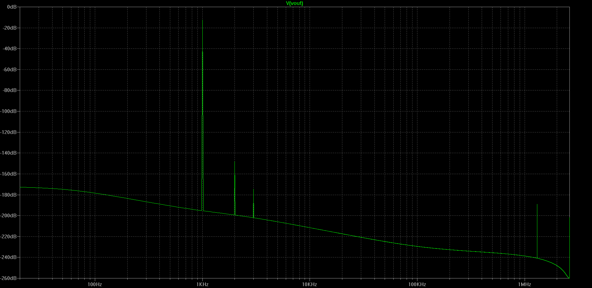

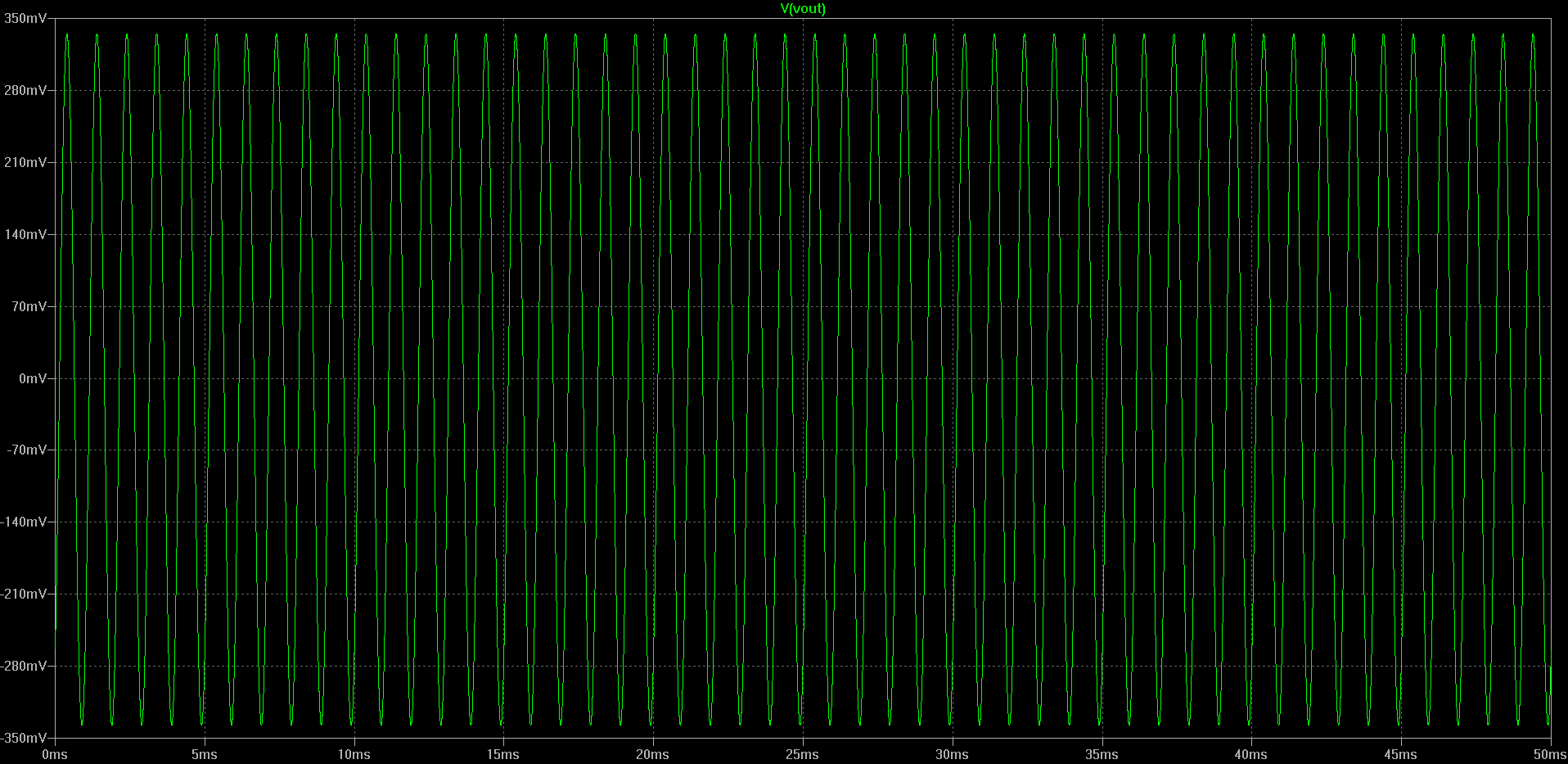

Hi People!
my 2 cents
this preamp is great sounding
bellow are the sims (5mV at Vin):
Harmonic Frequency Fourier Normalized Phase Normalized
Number [Hz] Component Component [degree] Phase [deg]
1 1.000e+03 3.363e-01 1.000e+00 -51.28° 0.00°
2 2.000e+03 5.592e-08 1.663e-07 -93.29° -42.01°
3 3.000e+03 2.722e-09 8.093e-09 175.60° 226.88°
4 4.000e+03 1.528e-10 4.543e-10 77.64° 128.91°
5 5.000e+03 2.048e-10 6.088e-10 78.06° 129.34°
6 6.000e+03 2.638e-10 7.842e-10 78.44° 129.72°
7 7.000e+03 3.337e-10 9.921e-10 79.18° 130.46°
8 8.000e+03 4.136e-10 1.230e-09 79.91° 131.18°
9 9.000e+03 5.042e-10 1.499e-09 80.44° 131.72°
Total Harmonic Distortion: 0.000017%
The input of the NAD3020 phono stage is also known as a series differential pair.
As it is the same current which passes through each transistor, their non-linearites added and do not compensate as in a standard diff pair made of transistors of the same polarity.
A possible advantage of the series scheme is a better behaviour at high frequencies, thanks to the lack of parasitic capacitors due to the CCS at the emitters in the standard scheme (which behaves better at DC).
The NTP does not cancel even harmonics like the LTP does. That does not mean it cannot give low distortion. I would give the circuit a chance. Cordell's models should be accurate enough if the simulation is set up well.
In most modern circuits the input stage is very lightly loaded, so it's the TIS and OPS that generate most of the distortion. For this reason a circuit may give the same THD regardless of NTP or LTP.
