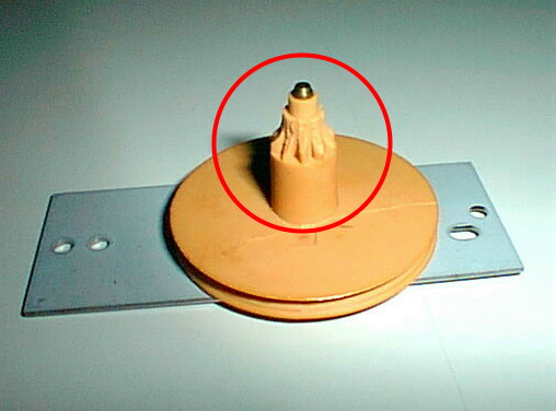

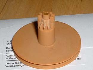

well, typical Bank Holiday blues!! :bawling: My Arcam Alpha 6 tray jammed. I took the top off, retrieved the disc and thought that was the problem solved. It certainly wasn't!! The tray would barely open and shut. I have removed the transport for investigation and found that half the teeth on the plastic orange turret (which is belt -driven from the motor, mounted on a silver metal plate and secured to the bottom of the transport) have been stripped.😱
Does anyone know of a good supplier of replacement CDM9 transport mechanisms? Or can I just get hold of this one single part (ie the plastic toothed turret)??

Don't scrap it or I'll come over to get it ! That is a serious threat :nod:
I know the orange gear you speak of and in my memory this gear has been modified. Don't know the part number unfortunately.
They were used in Philips CD9xx series too. Maybe finding one with a dead laser will solve your problem ? Finding a new CDM 9 will be difficult and expensive. There are some german companies that sell them for 140 Euro :bigeyes:
But I googled this one for you:
http://www.hinkel-elektronik.de/shop/2418.html
edit: oops, I made a thinking error: the gear is part of the tray not of the laser unit. Please contact Philips for the gear. CD931 and 951 have the same gear.
In my database I found a gear which description says:
Gear from CD-tray (open/close)
Part number Philips: 4822-522-33192
Cost: €4.56 without transport.
Could this be the one?
It's listed in the CD931 & CD951 database.

This might help.......worked great for me:
Here is the best info. I have on replacing the gear.
Good luck with the procedure.
Best regards,
Jonathan Hart
Customer Service
PS Audio, Inc.
3050 Broadway, Suite 201
Boulder, Colorado 80304
I bought the gear from Robinson Racing Products Tel 209 966 2465 or
www.robinsonracing.com
I found it on the web it is a 32 pitch 10 tooth gear their number RPB
0100 for $3.50. I cut off the remainder of the old gear teeth and
slightly cut down the gear end of the old pulley assembly so that
when I mounted the gear on it (tooth end up) ,I couldplace a clip ring
in the notch of the original metal shaft so that the plulley assembly
wouldn't slide of. You have to cut the pulley back slightly to give
just enouth clearance between the gear and the clip ring that it turns
easily. I got a clip ring from the local Ace Hardwaree for 11 cents.
The material of the old pulley gear assembly is so soft that you can
easily cut if back with a sharp knife. I then used epoxy to glue the
gear on the pulley assembly. Rememger the collar part of the gear must
be mounted down so that the highest gear is furthest from the pulley
wheel. Use slow setting epoxy to give a strong bond. The thing works
fine. John

I was amazed to see the pic on Eddie's site - exactly the same problem!! I have attached Eddies Pic and my own for comparison.
I'll be onto Philips tomorrow.
Thanks again. I'm kind of looking forward to re-assembling the kit.

Good News!!
The part is ordered and will be leaving Holland for the UK in a few days. All for a grand total of just over 4 GBP!
For everyone's records, Philips spare parts (for audio, DVD etc) are distributed by Dutchwest Parts. Tel +44 1434 323232. They were great - I also got them to quote for a full transport (in case the re-assembly goes horribly wrong) and it was about 54 GBP (68 incl postage etc).
Thanks again folks. Hugo's part reference number was very helpful - straight to the product. ISTR it was described as a "geared wheel".
Jon
.........and a happy end to this tale:
I spent a couple of hours this evening reassembling my Alpha 6 and............drumroll............it works perfectly!
