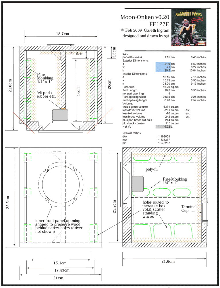

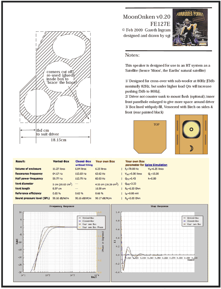

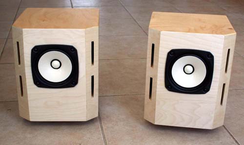

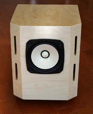

I've finished a new pair of Onken style speakers designed for HT. My first project uses the FE127E. I decided on a 6L box size to reach a hoped-for 80Hz cut-off (where the HT sub should take over). Dimensions were chosen based on convenient lumber sizes and to suit the final location I have in mind. I also made some aesthetic choices in terms of the shape & size and number of port vents.
I've had a lot of inspiration and help from the forum (such as Dave, Chris, Bob and others), the last thread I created in this regard is at: http://www.diyaudio.com/forums/showthread.php?s=&threadid=137666&perpage=25&pagenumber=1
Since this speaker is designed as an HT satellite I've named it after one !
And in case anybody likes the design I'll post my drawings (but do go and see what they're doing at planet10 where there is a wealth of design information and perhaps something more suited for your application)

Thanks for the positive feedback...
The sub is still on the drawing board. I am leaning towards something based on the SDX-7 (again, inspiration coming from Planet10). I have to decide if I want a floorstander for the front which will be based on the Moon + sub, or if I want more Moon's and a separate sub. What's your advice ?
I'll throw in a another photo of the Moon...

I may be going in circles, but it seem that there's no need for such a thing as a Fonken-woof then...
If you have a good Fonken then it goes down to at least 80Hz (and likely lower). So it already produces sound covering all the directional frequencies. You only need an additional driver for where the Fonken leaves-off, which is for non-directional frequencies. In which case you don't need stereo, you can use a single sub-woofer optimally designed and placed (which may mean not underneath your Fonken with all the dimensional restrictions).
The Tysen (can you post a link to this design?) is a sealed box, so the FR driver doesn't go down as low as 80Hz so it needs to have the 2nd driver in the same box because the XO sits somewhere higher.
And I go in yet more circles, because it seems you don't need the regular Fonken either...
If you are going to have sub-woofer (either single or stereo) you only need your Onken to go down to 80Hz which needs only 6L for a BR which brings me back to the Moon-Onken

I know that the specifics of the design have to change to accommodate different drivers, I'm wondering if the general approach is feasible.
Anyone have an Onken calculator handy?
Most likely I'm wrong on this count, but you don't need an 'Onken' calculator. It's really the same thing as BR. At least when I use a BR calculator to review other people's Onken speakers, their designs match up with the BR results.
Try this: http://micka.de/org/en/index.php#ideal
The idea is that you use long thin ports. In the calculator I've linked above you can enter dimensions for your 'own box'. You can adjust them to get the response curve you are looking for (i.e. mostly flat). People have all sorts of guidelines, like a 'real Onken' needs ports that are at least 35cm long. I say phooey - so long as the port has enough 'resistance' to the air-flow it will dampen the BR resonance which is the hallmark of the Onken. Shorter ports just mean they have to use high aspect ration openings (long and thin). This forces the air into contact with a much larger surface area along the port and it's this that provides the air flow resistance.

Depends on the alignment you're shooting for.
True, though some folks believe it's a form of TL.
Well, you ideally use at least (8) vents (the original had (13) metal tubes) that ideally sum their areas to = driver Sd, with 0.75*Sd the acceptable minimum.
No, the vents must be < ~35 cm long to keep vent pipe harmonics reasonable. It's this spec that keeps most modern drivers from being suitable for proper Onken loading due to not having a large enough Vas.
A 'real' Onken's 'claim to fame' is its massive vent system which has a high acoustic efficiency not unlike some PR vent systems, while the more resistive vents that rely on friction and/or damping that Dave prefers does the opposite in that it reduces vent efficiency, so an apples n' oranges comparison with each having its own merits/trade-offs.
