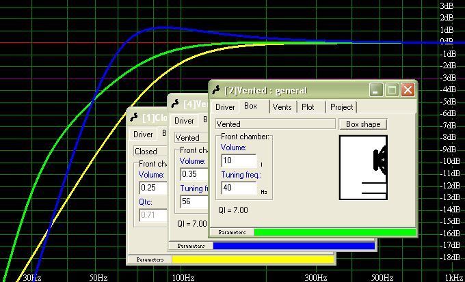

Baffle step appears minimal but its great value - easily worth it for
the bits if you want to mess about with the crossover and turn it
into a genuine freefield mini, otherwise its more AV bookshelf.
Sealed volume is as always flexible. Vented ~10L Tuned 40 to 55 Hz.
(possibly not bad as the top section of a budget 3-way either .....)

Can you suggest an L1 value to get an appropriate BSC level?
sdclc126 said:
Can you suggest an L1 value to get an appropriate BSC level ?
Not really without modelling it at least.
http://www.rjbaudio.com/Audiofiles/FRDtools.html
http://www.geocities.com/woove99/Spkrbldg/DesigningXO.htm
Passive Crossover Designer is easier than speaker Workshop.
Generally the main inductor is around 2 to 3 mH, but you
would have to play around with the other c/o values.
🙂/sreten.

Might as well throw in the maximum sensible volume,
which is around 14 Litres / 0.5cuft tuned around 44Hz.
A slim angled back baffle floorstander would be possible.
Sound quality to expect ? Search on "swifty" here which covers
another madisound cheapo special and make your own mind up.
🙂/sreten.
