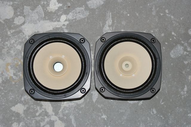

Part 1 - Coating the FE167 cone …. I found some Mod Podge (aka Puzzlecoat) in my local Arts and Crafts store, so took the divers out and gave them a single light coat. This is a very quick and easy operation and as it seems to be a modified??? PVA glue dries very quickly. So within half an hour you can be up and running again.
To be brutally honest, I was a bit disappointed in the results, the sound seemed to marginally "harden" up and voices sounded ever-so edgy? but I think I gained a little more "zing" in the top frequencies. Now I suspect some people would prefer this mod' but I rather like the softer sound of the original driver. So at this stage I'd have said I could have lived without this mod - however this is permanent but that didn't worry me as we are only talking small differences.
Part 2 - I'd order a set of phase plugs from Dave and they arrived a few days ago. Now this was definitely more scary I'd never attached a driver with a scapple before and could just imagine the damage I was about to do? Well actually if you follow Dave's pictorial installation and you haven't had 5 bottles of vino the night before it's rather easy.
Final result - WOW - what a different driver - mids are just soooo crisp, defined and smoooth. I always liked the original drivers voicing but with the phase plugs this sounds a whole heap better still! Now this qualifies Part 1 above …. with the clarity of the phase plugs the about coating comes into play and that "zing" in the top end just adds the shine up there? And the phase plugs have brought back that natural sound of voice but allows the coating to better control the cone and so adding to the overall improvement.
Picture doesn't show this but there is a faint gloss on cone after coating.
And yes - I'll probably EnABLe them at a later date.

Hi - I also bought some Dammar but luckily mentioned this before use - see http://www.diyaudio.com/forums/showthread.php?postid=1649426#post1649426 Dave replied back quickly he doesn't use this much?? And I got another reply that it (Dammar) might be better with more heavier repair work.
If you think about it (which I didn't) varnish is a rigid/hard coating where as Mod Podge is pretty light and is supposed to have some flex in it??.
I did get some brush marks on the cone but you'd have to get extremely close to see and the colour of the driver isn't really effected except for a light gloss.
I'd be very interested to hear what you thought your drivers sounded like after your treatments.
I'd certainly recommend phase plugs, they just raised the speaker to a new level.

Puzzlecoat retains flexibility until you use alot and or do both sides -- ie i'll do 3-5 fairly thick coats on the front and 2-3 coats on the back of a paper cone woofer i'll be using for sub duty. The "constrained" layer result of doing both sides stiffens things up quite a bit. You loose top end, but in this application that is a feature.
As i do it on FRs the prime purpose is to bond the top layer of fibres together to reduce cone self-noise. As well, i suspect (from listening and the resulting impedance curves) that it reduces the Q of the cone's resonances.
Greenie, i always do 2 coats on the raw paper cones... the 1st one sits into the paper of the cone, and the 2nd sits on top of the 1st coat creating a continuous layer .
dave

2 coats thinned puzzlekoat (ModPodge) on both cone and front of whizzer. 2nd layer will take less
EnABL pattern
3 coats of 50% Gloss on the cone (succeedingly less material required on each successive coat)
1 coat of 50% Gloss on the front of the whizzer and a light brush on the underside of the lip.
On the finished phase plugs, EnABL spots & 1 coat 50% gloss.
PVA nipple on tip, then 50% just on top
dave
