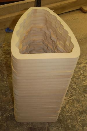

This is a result of a day and a half of work. I had an option of going to someone with CNC but chose to do it the old fashion way. Jig saw, band saw and a shaper. I did see this type of the internal anechoic chamber on Tony G web site and decided to over complicate things a bit. There are 3 semi random patterns stocked up internally. I will apply sound absorbing foam to each layer before glue up.
Figuring out internal volume is also a pain. I think I'll place each type of this segments on the flat surface, fill it up flat with sand and then measure the volume of sand in a measuring glass. Then do my math. My believe is that this enclosure will be very much dead internally.

Nice! ...especially the inside surface.
Have you considered adding internal cross-bracing?
A tip: if you can still manage to do it, try to include some sort of alignment guide. IME, it is difficult to align all pieces simultaneously.

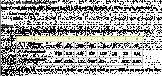

I make no absorbent material to specifically inform you about. There are Sabin tables for absorption coefficient VS frequency and thickness of common materials used for such purposes. Google and you shall see.

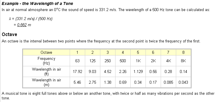

I reminded you that a wedge needs to be 1/4 to 1/2 the longest mode of interest in wavelength depending on its shape and absorption. 1/2 wavelength if hard surace. Your pattern will work far higher than your chamber has its modes. So you did lot of work for little or no return. That's all.

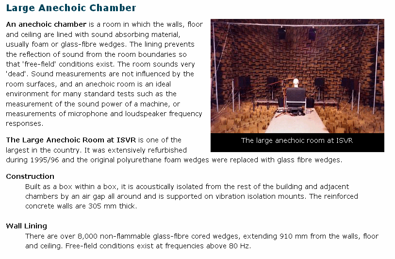

In the attached picture you can see the Southampton University anechoic chamber with 910mm fully absorbing wedges officially rated good above 80Hz. They are a bit optimistic still. 100Hz would be secure.
Meyer Sound states that 10 to 20 feet fully absorptive wedges would be OK for 30Hz and 38 feet dimensions. So they rate their medium size chamber for 100Hz, and go outdoors ground plane for really low free field.

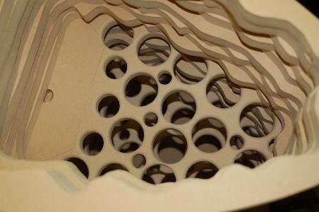

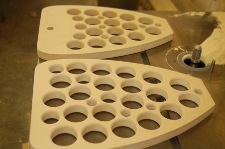

This is roughly what it's going to look like inside. I remember Planet 10 suggested a-symmetrical placement of braces and attaching the magnet of the woofer to the bracing. I am going to take up this task and try it. Unfortunately I don't have time or wish to spend another 2 days, building a test sample enclosure of the same size but with symmetrical braces and none of this wavy pastern on the sides so I get whatever I get and so be it.

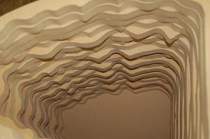

Salas, the acoustical foams that I've measured before become effective 800hz and up. At lower frequencies they are barely doing anything at all. So, my question is, why bother with the foam at all.
Not trying to be a pest here, just interested in your opinion.
My opinion is that, sound absorbent or not, this type of a surface will create diffusion on all frequencies and with sound absorbing none reflecting foam will become much more effective.

It's not a matter of an opinion unfortunately. There is acoustics.
It would be great to diffuse all frequencies. But if your ''waves'' are about 3cm long you are going to diffuse about 6kHz up. If you line foam over the waves, no diffusion is going to take place because the foam will soak sound waves very effectively at 6kHz and up.
One thing is that I doubt you are going to excite enough energy that high in frequency via the woofer. There are structural side benefits with your approach, and the absence of absorbents some do find 'lively' although its just another coloration that must be expertly mixed.
Use 10cm thick Rockwool for top and bottom and leave your wave pattern exposed. That is what I would do given the situation as is.
