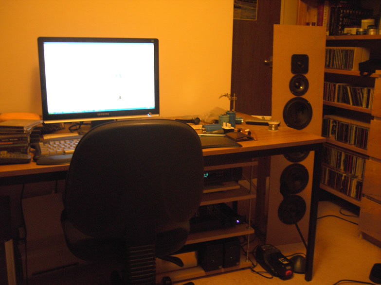

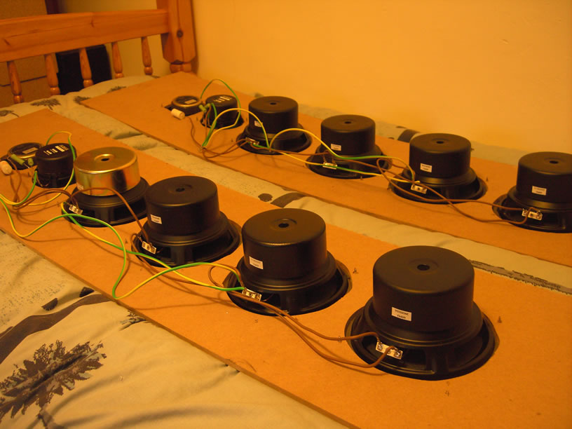

Just so people can see what we're dealing with, here's the right hand speaker in situ. Note the flexing baffle, due to the heavy combined driver weight. The other speaker is bang up to the left-hand wall and farily close to the rear wall. I suspect more bass will come from this side, but thankfully it's not obvious when actually listening to music.
Simon

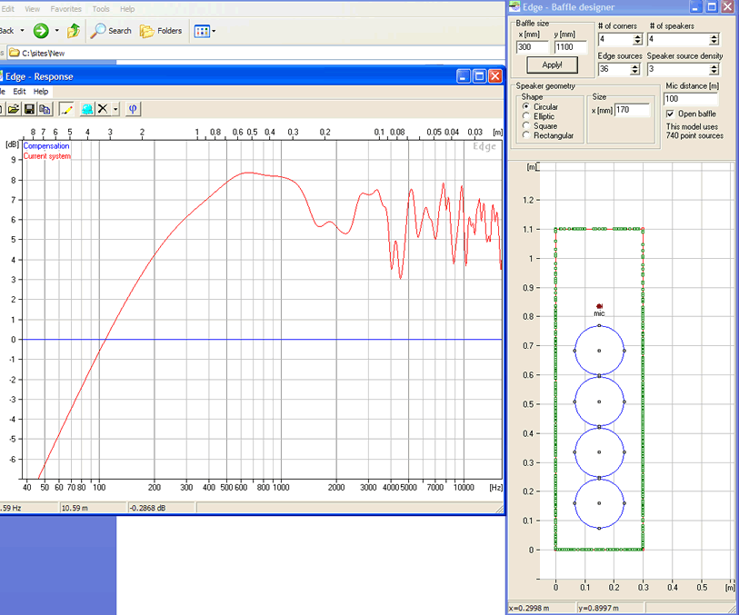

What is the baffle size and have you simulated it? Just from the looks it seems very narrow for an OB so the dipole rolloff would begin at fairly high frequency?
Just a personal experience, the narrowest I could use was 45cm. This will give about 50-100Hz, and if equalised actively can go down to 30-40 Hz.
The baffle width is 30cm or 12", it's extremely narrow for sure, but also the very widest that fits in my tiny room either side of my "computer desk".
I'm going to hack my desk down and allow for maybe 40cm baffles, when I get some dry weather!
I haven't simulated the baffle, can you recommend any easy to use software?

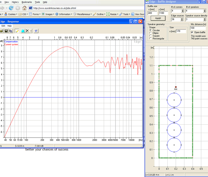

Here are the same drivers, slightly offset, on a 40cm baffle.
Judging from where the response dips to 0dB, I'd say this arrangement will provide about another 20hz extension, which should make a very substantial improvement. The upper midrange is smoother too, which may or may not audibly improve the region slightly beyond the crossover point (first order so problems at 1500hz might be audible).
