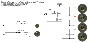

I've been working on my speakers today!
I built Graham Maynard's T-bass circuit, which has added some bass extension and power, whilst seemingly reducing the upper bass peak.... the difference between hopelessly coloured and really quite a good speaker.
I then relieved the midrange driver of bass with a 1st order high pass at about 250hz. So far so good. I then found the treble was a touch too loud, which 1.5R cured nicely.
The midrange still has a slight upper emphasis, which is intended to be reduced by a 1st order filter. As I don't have those parts yet I tried a zobel/impedance compensation network on one speaker, but I'm undecided on the usefulness of it so far.
I've attached a schematic of the work in progress so you can see how I've wired things. Really I did it to keep track myself!
Simon

Hi Simon,
A couple of quick suggestions.
Re LF drivers and the series-parallel connection. If you join the neg wires from the top two drivers together you have two drivers in parallel in series with another two drivers in parallel instead of two series chains connected in parallel. This averages the mechanically induced coupling effects prior to series connection, instead of leaving any loading differences between series connected pairs to mutually influence each other.
You could have both lower drivers facing rearwards, no 1 in parallel with no3 and 2 with 4 before connecting these pairs in series. Might improve lower mid clarity.
I have a Zobel across my LF drivers - try 10R and around 47uF, plus another series choke after the transformer output to match the driver. This choke removes some LF-mid driver interaction when the mid has a series capacitor. Do keep readjusting all of your T-bass values as you shift the relative level balances elsewhere within the project.
When a tweeter is used it can be better to take some hf from the mid using a low value series inductance (>200uH), or, if the network has a series divider (like yours) by fitting a Zobel across its terminals (8R + <470nF)
A simple C to a tweeter can still induce fundamental resonance which increases harshness of overall reproduction. It can be better to fit a parallel damping resistor across the tweeter (try 8 to 22 ohm).
Sometimes the tweeter series C with a parallel damping resistor can behave like a Zobel for the mid, but this depends on overall system/connections.
As you say - 30cm wide is not going to give you much bass, and I don't know whether you or a parntner is setting dimension limits, but if you want to improve bass without re-introducing the cabinet-like sound you have escaped from, then can I suggest that you find some carpet offcuts, roll these into pipes, and set these against each side of your baffle.
I would need to leave fixing arrangements and roll dimension up to you, but carpet reduces baffle edge induced effects and significantly increases the length of the front/back path, which reduces LF radiation loss without causing the pressure reflections which can so impair enclosure bass.
The rolls can be drawn towards each other behind the drivers too, so that their contribution to the overall width might be no more than 3" either side for 6" rolls, and there is no way that wooden wings can create this kind of improvement. 6" dia rolls are like 18" extra baffle widthe !
Cheers ....... Graham.
Hi Graham,
Wow, that was more than a couple of "quick suggestions"!
I've now got some more parts and can respond a bit better. I'll try changing the way the bass drivers are wired when the crossovers are next disconnected. I find the idea of rewiring them quite daunting if I'm honest.
Changing which way drivers face could be done at the same time, but it'd certainly create even more spaghetti.
I might try a zobel on the woofers but I've just connected 3.3mH / 1.75RDC in series to attenuate and it's doing a pretty good job... of course it's also affecting other parameters, and yep, as hoped for the bass is coming on nicely.
Regarding the tweeter / mid crossover... I previously forgot to order the coils (0.22mH iirc) so I've done that today. I also ordered coils (0.39mH) to complete a 2nd order filter on the tweeter, to see if this is any better than 1st order here.

Hi Simon,
Always do original work in 'rough' and then tidy if/when satisfied. A single AA cell sits amongst my chokes and capacitors to check that the polarity of driver wiring matches what is intended.
Changing lower driver facing is not essential, but is a simple way of moving lower cones slightly forward without additional cabinet work.
3.3mH / 1.75RDC. If this is the dcR of the choke then it will have considerable effect with OB mounting. There will be audible loss circa 30Hz and lack of damping above.
The transformer bass circuit is not a substitute for LF crossover, but can reduce the number of degrees cut subsequently necessary.
Yes a plain resistor or Zobel network across driver terminals can make a big difference. With these observations in your ROM you will be able to process sound/component aspects as if second nature.
My baffles are 18" wide, but now taller in order to populate with decent cone area.
Cheers .......... Graham.
