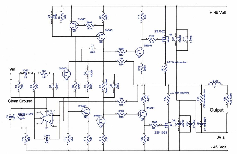

I would like to test the MOSFET amplifier designed by M. Renardson, from
http://www.angelfire.com/ab3/mjramp/amp7.html.
http://www.angelfire.com/ab3/mjramp/construct.html
http://www.angelfire.com/ab3/mjramp/simple5.html
Did anybody experiment with it? How does it sound?
I would like to ask some advice regarding the implications of increasing the voltage from 60V to 90V and eventually adding a second pair of MOSFETS for extra output power.
Besides choosing capacitors of higher voltage for the power supply and for the 4700uF output (100V instead of 63V), do we also need to increase the output capacitor from 4700uF to 6800uf or higher in order to accomodate the extra power?
If we increase the value of the output capacitor, since it is part of the feedback loop, do we also need to adjust the values of any other components ?
Do we need to increase the value of the power supply capacitors from 12000uf to let say 20000uf?
To add a second pair of MOSFETS, I assume that I would need to add another pair of resistors (330R) and 12V zener diodes to drive these MOSFETS. Is this correct?
Any other advice is welcome
Thanks!

As a huge fan of Lateral FET's I have to add my two penneth
Easy bits first, yes just add an extra pair of 330 ohms and parallel the outputs. You could always use double die MOSFET's instead such as BUZ900D and BUZ905D (TO3 Package). The 12 volt zeners, it's not usual to use back to back zeners, normally just a zener and series In4148 if you want to include them at all !! I normally do not.
The value of the output cap is unrelated to power output.
I imagine it sounds -- well -- very nice
Any reason why this particular design ?

Hi Karl,
Thank you for your feedback.
I looked at this design because of its simplicity, yet very low noise/distortions and good linearity.
I would like to build a multi-channel home theater amplifier, and eventually pair it with one of these speakers: the Gallo reference speakers (http://www.roundsound.com/reference-speakers.htm) or the Druid MK4 (http://www.zuaudio.com/druid_2.asp).
I think that increasing the voltage I may be able to get at least 80W of power, which should be enough. Maybe I would need a more powerful amplifier for powering the woofers' second second coil of the Gallo speakers.
What do you think about a design that uses symetrical voltage? Could we get similar performances using only 7 transistors? Such a design may have an advantage that the capacitors will need lower voltage, and I could also get more power, especially for the woofer speakers.

There is something more... I looked again at the schematics, and the zeners are after the 330 ohms resitors, which makes it more difficult to add another pair of transistors, if we keep the zeners. Therefore your idea to use the BUZ900D and BUZ905D MOSFETS would be better.
Do you know where to buy a matched pair of BUZ900D and BUZ905D?

Looks very similar to an old Maplin 75WRMS amplifier.
There seems to be quite a few more components than is absolutely necesary in this design. Typical of a designer who has been around a while !
I prefer to stick to simple designs. I dont use zeners on the MOSFET gates. I lose the output inductor. I keep the zobel network tho. I would only use one low pass filter on the input.
I probably wouldnt use the 1000uF on the output stage.
Implication 60V to 90V
Now that's a drastic change. You would at least need to check the biasing and check the SOAR of all transistors. I don't have the time at the moment to have a more closer look to the schematic, but from experience I doubt that you can increase rail voltage by that amount without reworking the circuit a bit.

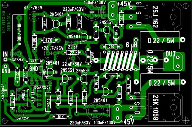

I have read through your "My MOSFET Amplifier designed for music" topic, and there was a lot of excitement around.
There were several comments and possibly some changes in the original design and board layout. Can you please post the latest schematic and PCB layout?
You have also given a lot of information about measurements and components types. Do you have any website with all these details summarized? Otherwise, would it be possible to have the final conclusions compacted in one post? This would be very helpful!
Thank you also for the link for the components!

Sorry for not replying sooner --- for some reason not notified of new posts on this thread -- Gremlins
The circuit is unchanged component wise apart from a 10 ohm 2 watt resistor across the output inductor. I kept missing it off the CAD program when I copied it over from the hand drawn originals.
Alex looks to have done a fantastic job with the PCB layout. I have "visually" checked it over and it looks fine. As you will have gathered the originals were very much a one off.
A website I have only had a PC at home for 18 months or so. It was hard enough figuring out how to send an E-Mail.
Final conclusions, thats easy,
BUILD IT. LISTEN TO IT. REDISCOVER YOUR MUSIC COLLECTION.
This amp does truly sound wonderful, you can close your eyes and be transported away with the music. You will find you are not listening to the amp, the music shines through. And that is the problem for me in that I wonder now how to improve on it subjectively, after 4.5 years it still has all the magic, nothing I have heard has made me want to change it.
If you do intend building it I can give any advice etc via this forum.
Regards Karl

The ratios of the resistors will stay the same so you might not need to adjust any.
Just watch the pwoer rating of the resistors at higher voltages.
Check the transistors in the driver stage are correctly rated for higher voltage.

I am not sure I have understood correctly. Are you mentioning that the resistor R25 which is a 10 ohm should be 2Watt, or is there another resistor missing from the schema?
So apparently there are at least two schemas that are intriguing, which is yours and also the MJR-7 of Mike Renardson. I may also try another one from AmpsLab: http://www.ampslab.com/lm60.htm or http://www.ampslab.com/lm60_schematics.htm
Before ordering the components, my I ask you a question about your choise of transistors. The schema contains 2N5401 and 2N5551, instead of BCxxx or BDxxx series (BC549 or BD139, BD140) transistors, or 2SCxxxx or 2SAxxxx series (2SC2547E, 2SC2911, 2SA1209) transistors found in the MJR-7 schema. Do the 2Nxxxx transistors have better audio properties?
If I will use two of the final MOSFETS in paralel or a BUZ900D/BUZ905D or equivalent, for more power into 4 ohm do we need to replace the transistors Q6 and Q7 with a medium power version? Which transistors should we use in that case for Q6 and Q7?
Do you have any suggestions on what type of capacitors to use, ceramic, mica, polyester, polypropylene? Which one did you use?
Yet another question, maybe for everybody: do we need to pair any of the transistors? I assume that using transistors in pairs with similar gains would improve the sound, wouldn't it?
Does anybody has a simple circuit that I could use to pair the transistors (Biploar an MOSFETS) by measuring the gain (output/input)?
Is there any website where we can buy paired transistors?
