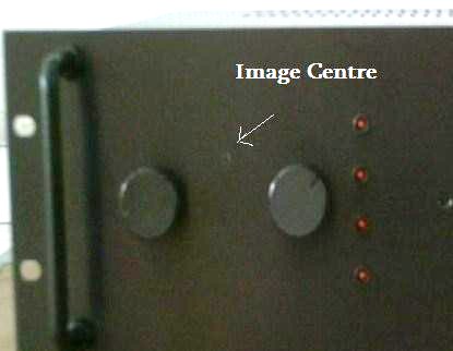

P.S. I never mentioned the "balance" control but here it is. It's a multiturn pot.
