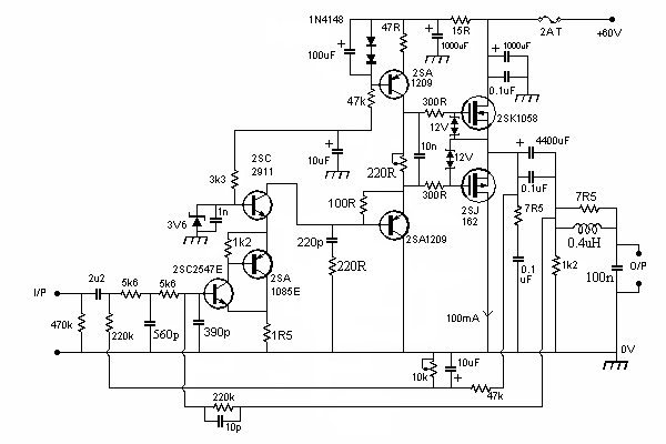

The 12 volt zeners, it's not usual to use back to back zeners, normally just a zener and series In4148 if you want to include them at all !! I normally do not.
In Renardson amp the zener's are included after the 300 ohm resistors while in other schematics they are before the resistors, or are missing.
Is it ok to move these zeners before the 300 ohm resistors. This way I could easily add another pair of transistors and 300 ohm resistors.

Considering that the the amp provides at ful power a peak voltage of 30V on 4 ohm, this means 7.5 amps peak current. The average current should be 7.5 divided by the square root of 2 = 5.3 amps. Is this correct?
Considering that the rail to rail voltage is 85V than the average power consumed is 85 * 5.3 = 400.5. Does this mean that I would need a power supply that has at least 400 watt of sustained power for one mono amplifier? Is my computation correct?

You have to be careful with supply lines on amps.
While its easy to think 45 volts is OK for an amp it doesnt take into consideration transients in the music. Music has a huge dynmaic range.
I was shocked just how quickly the transients were clipped on my amp. So in the my next design I went for a 55 volt power line.
This also fits in well with 63 volt electrolytics which are in abundance.
I have even seen on this forum people using upto 130 volt power lines !!!!!

The gate protection diodes ( if the amp is for your own use and you are not going to be shorting the outputs etc) I personally would not fit them. It's different in a commercial product that has to be as abuse proof as possible. If you move the zeners, there would be problems, the other side of the resistors is at a lower impedance, so more, possibly destructive current could be drawn + if they were triggered into conduction and the "characteristics" if you can call it that of the limiting action would be severely compromised.
Your transformer-- always use a bulb (mains filament say 60 to 100 watt) in series with the mains for testing, and not just for the tranny wiring but the whole amp as well.
Oh yes the primary windings, connect in parrallel. Which way round you ask --- use the bulb method, the correct way will draw no (minimal) current, the incorrect way and the bulb will be at high brightness. Now imagine trying that without the bulb

- MJR-7 Mosfet Amplifier of M. Renardson
